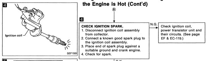

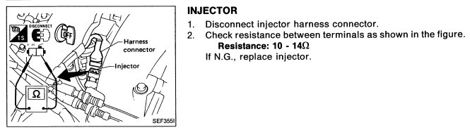

To start these are the things to check from a Power Balance Check (right hand list below):
Check the ignition and injector connections for cylinder 4 for corrosion/continuity. Then:
and:
Check the PTU connectors for corrosion/continuity.

Thanks Andrew. Appreciate the details. I’ve had the coil pack and plug out on cylinder 4. Checked both with multimeter and both ok. Checked spark was getting to plug using a spare plug, ok. Can’t seem  to gain access to injector, not aided by the strut brace.  Spark Plug from Z is a little bit more carbon coated than I’d expected and probably due a change. Connectors all look good and clean. I only use the car on dry days and it’s garaged.
