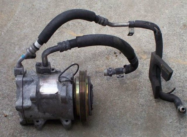

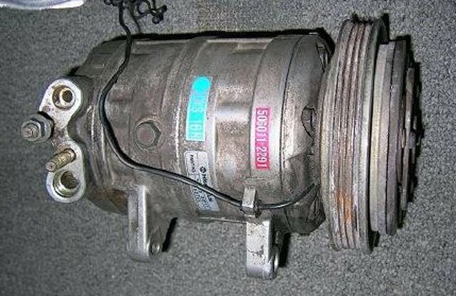

JDM and UK/Euro/US spec compressors have different coolant pipe connections.
JDM:
UK/Euro/US
That’s a great help, thanks a lot for that [emoji1417]
