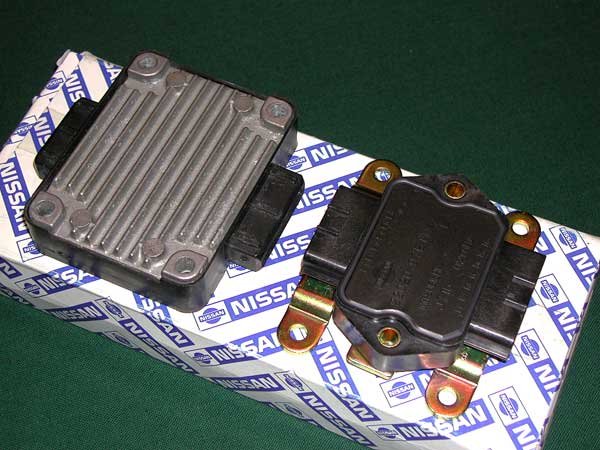

Did Nissan put the car on a Consult (or similar) diagonstics check? Have the connections to the PTU and MAF been checked for
corrosion and continuity? If you have an early style PTU they were prone to failure with symptoms you have described.
Early PTU type on left.

Hello . Thanks for the answers. The car isn't from UK. I don't know what kind of diagnosis they made, but the PTU on the car was early style, and with the new harness, I put a new style one. So, that was not the main issue, although they said the old harness was also not working well for sure. I've been searching a lot of things about the oxygen sensor, is there any chance that could be the problem. I tried to unplug it, and did not make any change, I don't know if that's what it's supposed
