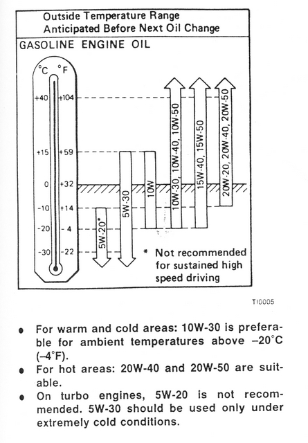

As Andrew says, a "30" grade, when hot, it a little too thin for a twin turbo.... Best go for a "40"
10w40 semi is more than adequate - and what Nissan originally specified - but a 5w40 fully synthetic is also a decent upgrade, by modern standards.
