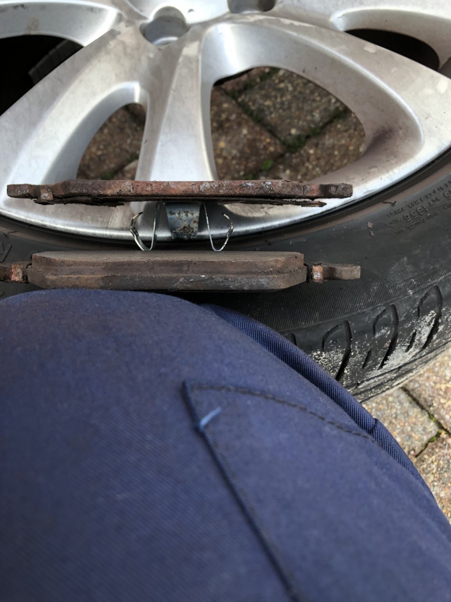

I had to borrow the wife’s car a few days ago. As soon as I set off I noticed the brake pad warning light was on and a horrible rumble when applying the brakes.
I remembered that the MOT, which was about a month ago, had advised that the disc needed to be changed but the pads still had some meat on them (not that I would have kept the pad when changing the discs).
I went out and set about replacing the discs and was horrified to find this...

2 hours ago, redwine300 said:
Some MOT station!!
I’m guessing they can only test what they can see?
As for the picture, I’ll try and post something next time I’m back there. ?
Surely they would see this with a simple visual inspection?
Not to mention the rolling road test..
