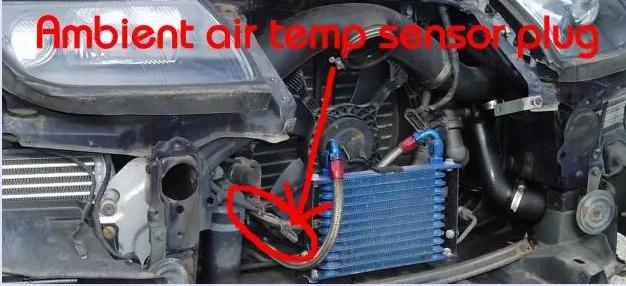

Anyone got a Picture of ambiant temp sender location??
Just out of interest because when I was messing around in the front of the zed I seem to have effected the ambient temp reading on the dash board. Not sure if i've damaged something but where does the temp sender hang out. I have been told in the past but cant remember.........car has been packed away for yrs. Cheers

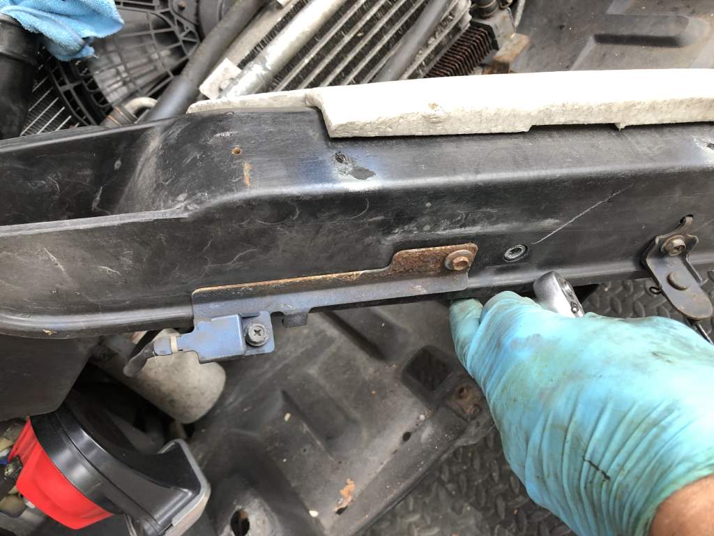

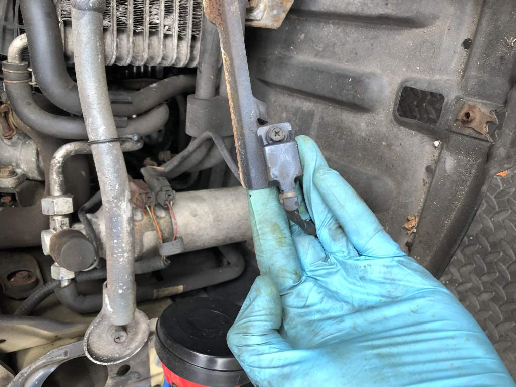

Behind the front bumper, often does not get plugged back in, that normally causes an outside temp reading of -81 or similar, makes running the air con difficult as the climate control system is confused by the incorrect figure.
Jeff

Mate your a star. I'm sure I haven't got one. Will look at weekend.

No problem. If I remember correctly it’s connected to the grey connector you can see on the AC condenser canister on the last picture.
