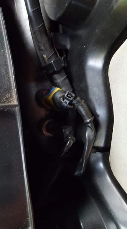

The old sensor harness was held down with a cable tie till the new one arrived.

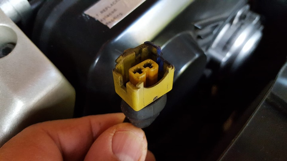

The clip was damaged and very brittle.

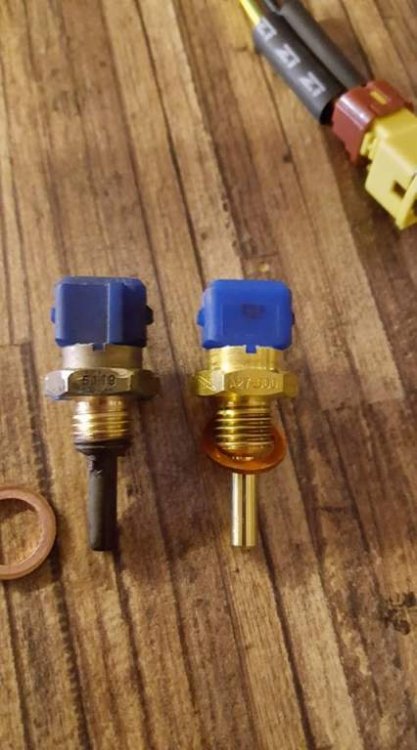

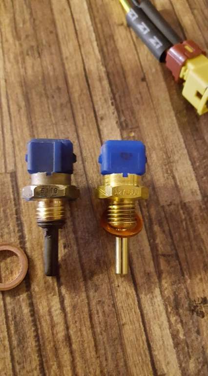

Old and new.

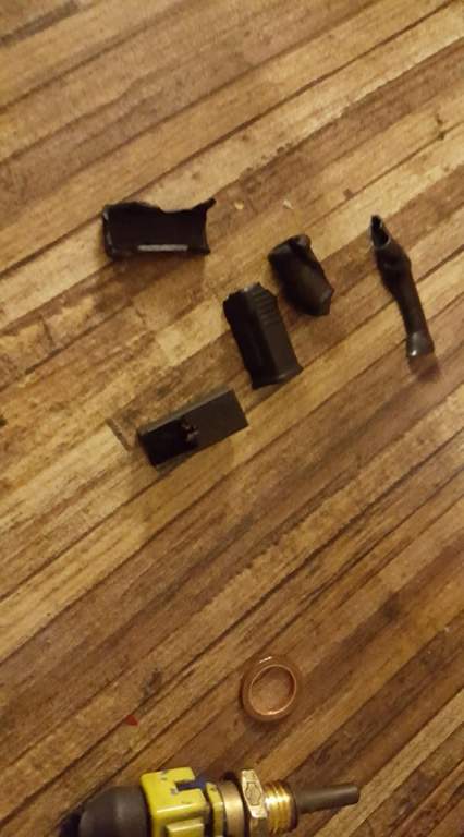

The coolant sensor harness also disintegrated so a spade clip was used on it till a new one was ordered.

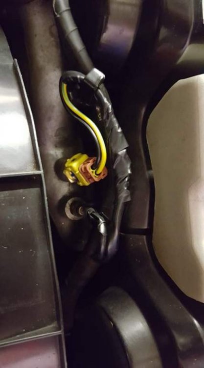

All fitted and wired up. I soldered the joint in the wires and shrinked wraped it then taped it all up.
