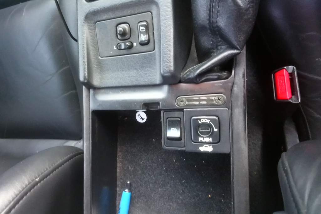

unlike all other models of the 300zx the vert boot can only be opened with a key
obviously it has the key lock in the usual place in the rear panel, but it doesn't have the release lever down the side of the drivers seat like other models
instead the boot release and fuel filler cover release are in the center arm rest storage thingy
the boot release is operated by a solenoid (located behind the boot trim at the back of the boot (ie behind rear light center panel) and is triggered electrically from the switch marked "push"
the push switch can be locked out using the master key in the keyhole in the middle of the switch. the valet key will not work here (so when you give the valet key to the parking attendant they cant steel your luggage from the boot) i always park my own car so i leave this lock in the unlocked position
further to this you also need the ignition key turned to power the solenoid circuits
the boot lid and the roof storage compartment lid (which is also solenoid operated) are interlocked so only one can be opened at a time (more on this later) so if you still cant release the boot, check the roof storage lid is latched properly
