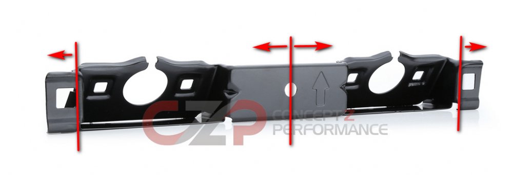

Noticed today that one of my number plate lights is dangling down a bit, upon closer inspection the bracket that should hold it in place has all bit disintegrated on the left hand side and I cant imagine the right side isn't fairing much better.
Does anyone know the part number for these for a UL Spec rear bumper?
I've tried searching multiple sites including JP-carparts but they only list the Jap spec or US spec parts.
Cheers
Andy
Thanks for the reply mate and for the part number, will have a snoop around to see if anyone has it but if not I'll make a custom bracket to replace the one on the car.
Cheers
Andy
For clarity, the brackets are different between UK and Jap spec zeds, so will be a different part number.

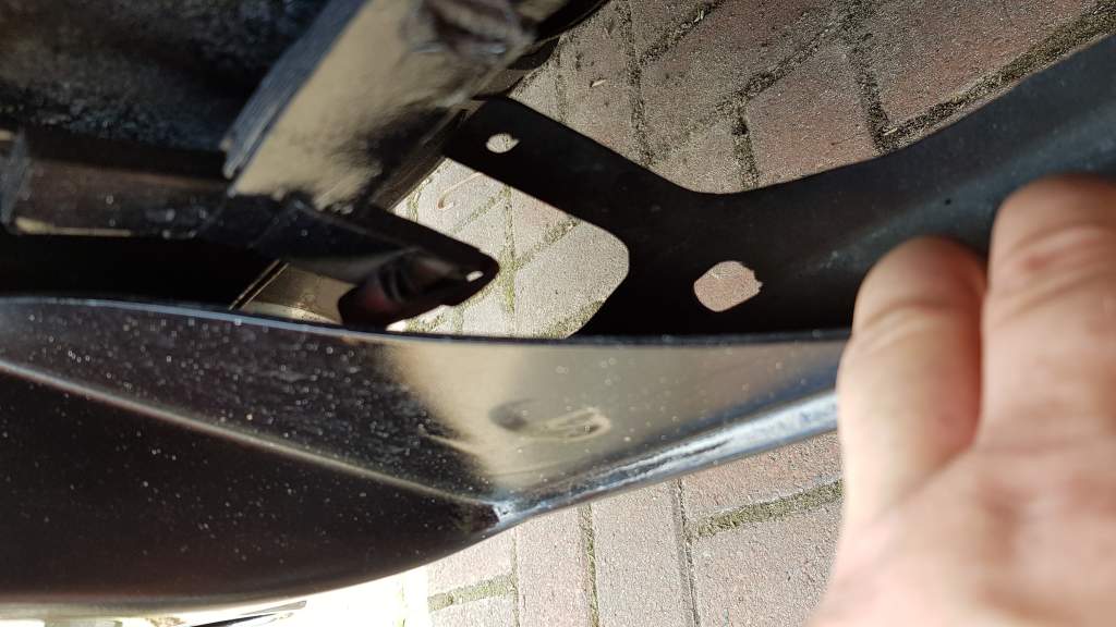

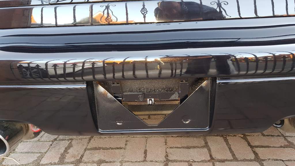

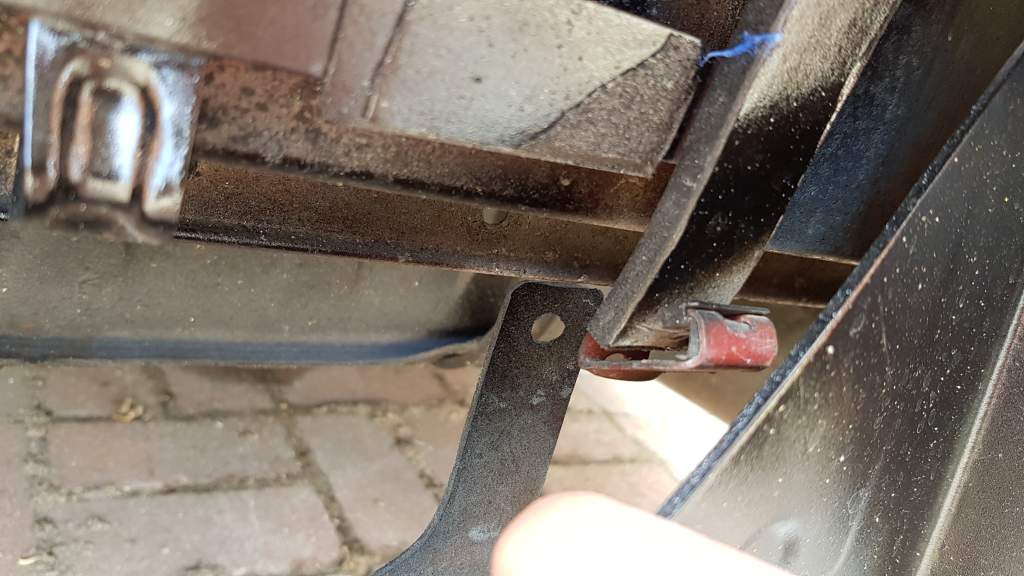

Interesting post this given the timing. So I've been rebuilding my black Z up and was looking at the number plate bracket. Different question to your lights one but seems a sensible question here...
I remember the number plate used to have a couple of arms that the bottom of the play would stand on. I thought these were welded on. What I found was that they've been bent up behind the bumper, but I'm not taking it off to try and sort. Managed to still bolt the plate using the top 2 screws. Thought it might not really be worth bending them back etc.
There is not a lot of difference between the UK and JDM/US brackets apart from a longer middle section and
mounting tabs at each end. The sections that mount the lamps themselves are the same. You could therefore
start off with a good s/h or new JDM/US bracket and cut and adapt to fit the wider UK spec bumper holes and
fixings. That's what I plan to do.
