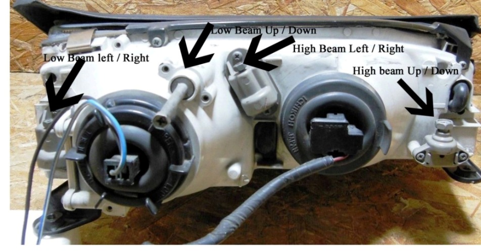

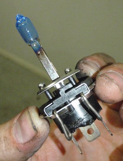

I know the bulb is a H1. But when I look at a bulb guide, the picture shows a connector thingy. I don't recall that and there isn't one on the z when it's come back. Just a connector like in the second photo. Am I missing something here?

The H1 bulb unplugs from the factory holder/adapter which the connector in the photo is fitted to.

Sorry, I obviously haven't been clear enough here. I have the plug plug as in photo 1 (right hand side). Everything else for that light is missing. So I'm asking what should be there so I can buy it.

Thanks for the updated photo Andrew. So I'm missing that whole base bit that the bulb would push into? I knew something seemed a miss

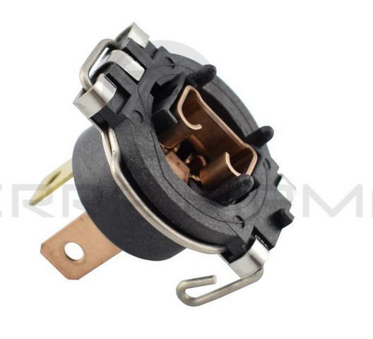

Here is a better picture of the adapter and the second picture is the metal headlight bracket it clips into.
[ATTACH=CONFIG]117235[/ATTACH]
[ATTACH=CONFIG]117236[/ATTACH]
Perfect. Just what I was looking for. Thanks Andrew
