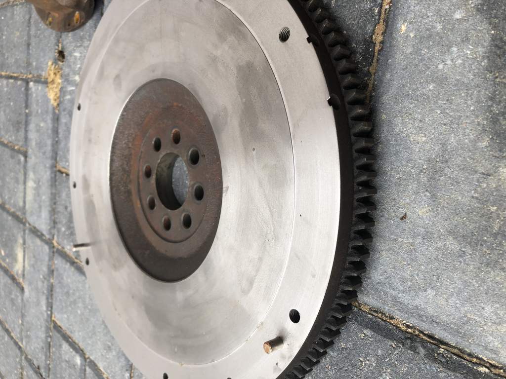

I am fitting a TT clutch and gear box into my na, so reading that having a flat flywheel on an na is ok but the TT requires that step. I believe it is all to do with the extra pressure from the pressure plate for the additional torque produced by the TT beast's.
Would you happen to know what the diameter of the raised portion is?
Or do i need to measure the new clutch plate and have it re cut to reflect that diameter?

It needs to be enough to fully engage the clutch plate and to allow the pressure
plate mounting flange to properly sit on the lower part of the flywheel.
Without the step, the clutch will not clamp so tight, seen this mistake made plenty of times over the years, it is often easier to get hold of another good used one or buy and after market lightened one.

I measured one today with a straight edge and feelers and it came back at .011".I have no idea if its been machined before though.
Thanks for that Jimmer i will measure the clutch plate and the inside edge diameter of the pressure plate so i will know how much space i have between them and ask the company to re skim to suit.

Just dropped off the flywheel to have the 0.011” 0.279mm step cut in left the old clutch and pressure plate with them to make sure they get it right hopefully.

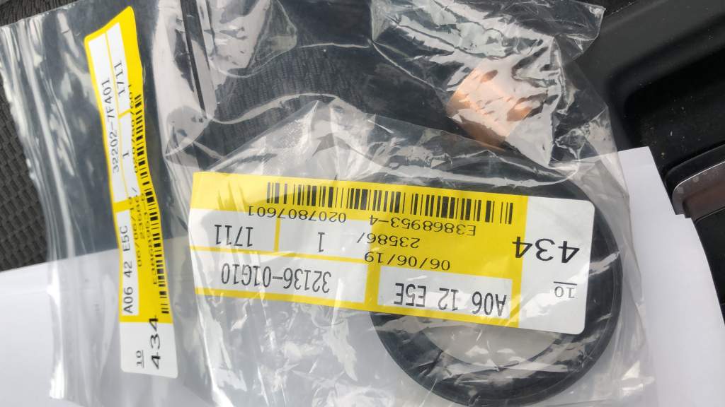

Have also just picked up the pilot bush and rear gearbox seal
I have now got my flywheel back now with 11/1000” or 0.278mm step let’s hipe it’s right this time

Going to replace the main seal behind the flywheel. Any suggestions how that comes out? Looks like a plate above it but not sure if that comes off before hooking out the seal?
