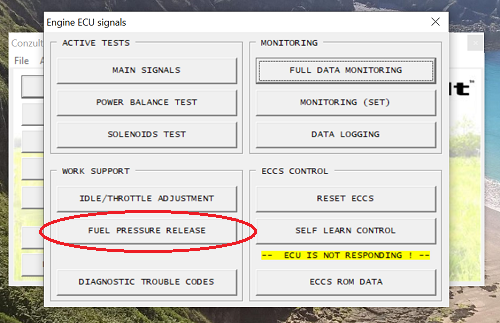

ConZult has a fuel pressure release button - if I use that, do I need to do the remove fuse / crank engine to release fuel pressure as in the how-to, or will using the ConZult fuel pressure release be enough? Thanks.

Yes, same function as Nissan's Consult.
Thanks - I see the manual says to crank it a few times after using that function. Which sort of implies needing to remove the fuel pump fuse in case it re-pressurises the system.
The ConZult button is this one:

The ConZult button is this one:.
Same function, kills the power to the pump. Engine dies of fuel starvation. Crank the engine over to make sure there is no
residual fuel under pressure. Then leave ignition off (take the key out if you want). Do the filter change catching any fuel
dribbling out of the broken joints. You can leave the fuse in situ.
Crank the engine over to make sure there is no residual fuel under pressure.
That's the bit I'm being a bit dense about - what to do after the engine has stalled. Does this mean use the ignition key to try to start the motor (in which case, why won't it just start?) or something else?
So long as the key is kept in the "ON" position after cranking the engine (with the ConZult still connected) the ECU will still be powered up
and keep the fuel pump off. The ECU will reset (and control the fuel pump normally on the next start) when the key is removed and power
is cut to the ECU.

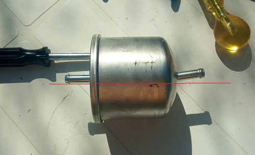

The JeffTT method worked fine. Careful as the filter itself is full of petrol (no, really :) ) so be prepared for a bit of spillage and have something ready you can drain the old filter into. An old towel tucked under the filter before you start catches the drips as you remove the hoses. The clamps can be unscrewed quite a way to get them pushed back over the flange on the filter pipes. I found it easier to disconnect the engine side one, then loosen the battery side one and loosen the filter clamp to remove the filter (bit of screwdriver leverage on the hose while wobbling the filter) rather then disconnect the battery side one before removing the filter as it says in the how-to.
I noticed the old filter had a bent pipe. This, and the cable-tied air hose and the borked MAF grille makes me think someone's been a bit cack-handed. Not going there again (don't worry, nobody on here, just local garage).
