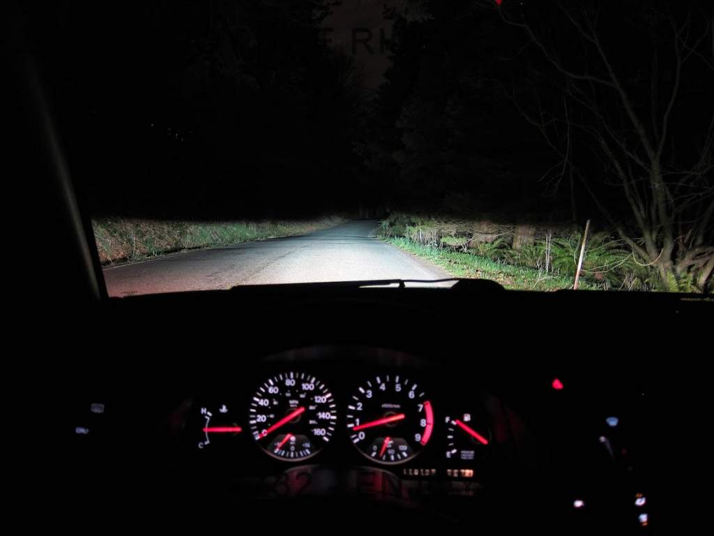

Just out if interest has anyone got '99/'2000 spec factory headlights fitted ? What are they like ?
Not mine, but you get the drift...
When I had the green Zed I put Hids in the Dip, main and Foglights.
The foglights were absolutely magic. They would light the road ahea at a low level and and you actually see the road in the heaviest rain or fog. I tried putting 100 watt in the heads but that didnt make much difference so I put HIDs in the mains as well and that really worked
