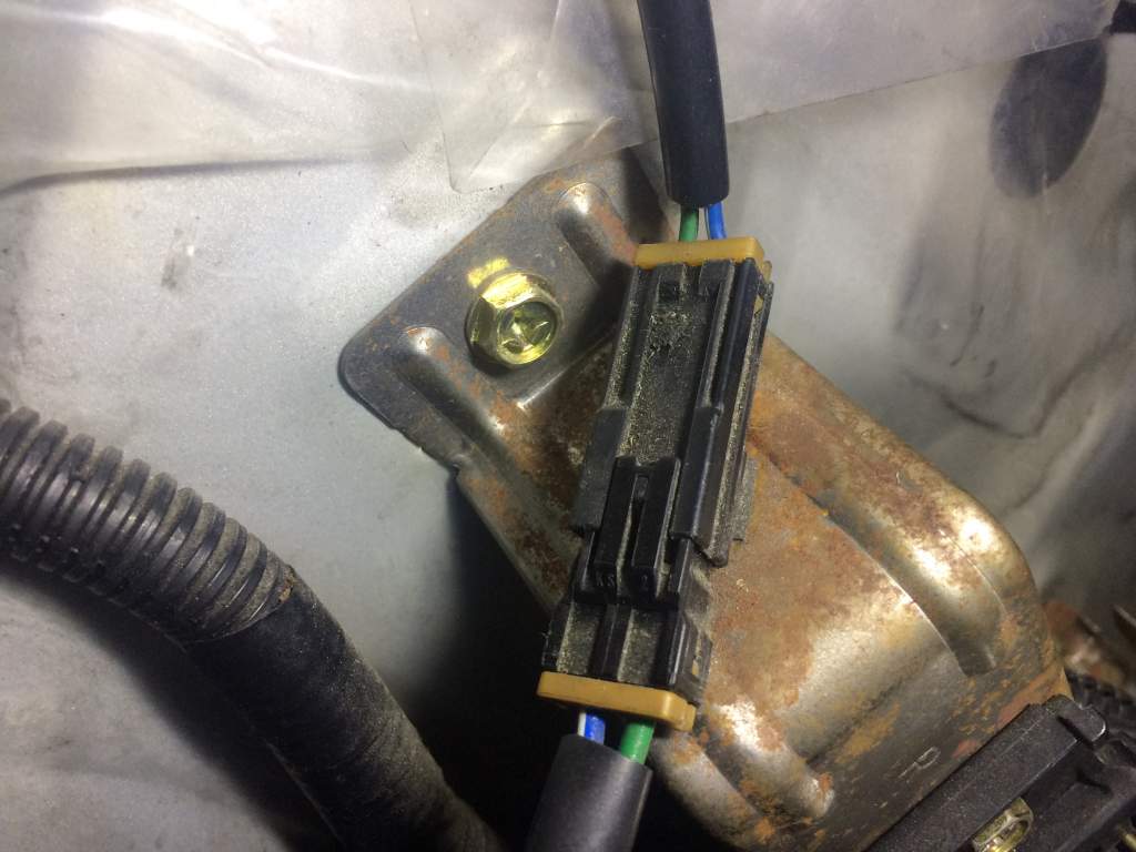

Ugh, the wires have been tampered with!
Am I right in saying that from the relay/amplifier/black box unit, two wires should go to the window regulator motor itself? Thick green, and thick blue/white?
The green on mine is snipped. The relay/black box end connects to a thick yellow/blue which goes into the car. And the thick green end that comes from the motor connects to a thick green/black, which likewise goes into the car. Haven't been able to find where they go.
Likewise with the switch loom. The large white/black wire at the switch end is connected to a thick yellow wire that goes into the car. And the other end of the snipped white/black connects to a thick green wire, which again goes into the car.
I'm hoping to magically find a relay of some sort these all connect to for an unknown reason. Only thing I can think of is if he's done this for some kind of switch for the immobiliser he fitted. Just gotta find out what the wires are and where they go!
If the wires are the problem..

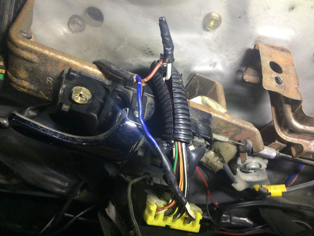

Later i'll look into this, my door card is off and i'll see if I can shed some light for you.
This is an aftermarket issue as you have like mine some sort of window closure linked to an alarm, should still work though with manual control.
Look at the pics of mine below, I've got blue and brown going into the car, aftermarket colour/wiring of course.
Yep mine looks just like that!
I'll check out all my alarm wires incase I did something when I had the box off.

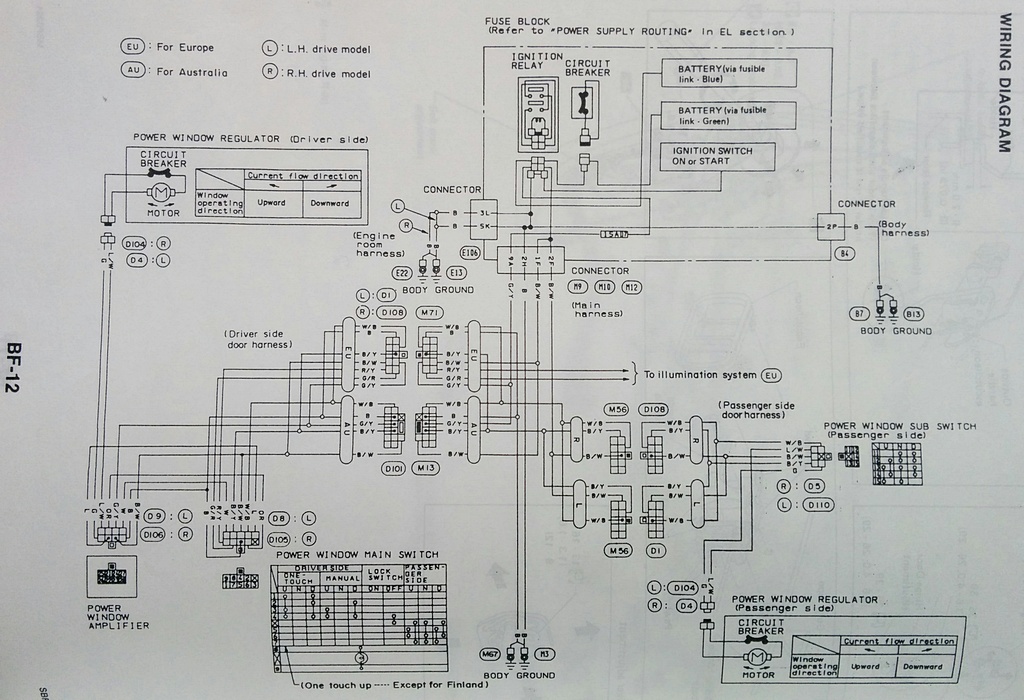

Cheers for wiring diagram too Andrew.
