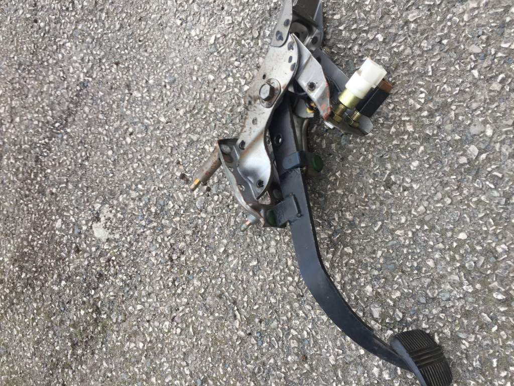

[ATTACH=CONFIG]114168[/ATTACH]
That what you are after??
Yes, do you have that for sale or is it a stock photo?
That picture is not a TT clutch pedal just checking you guys know what your dealing with.
