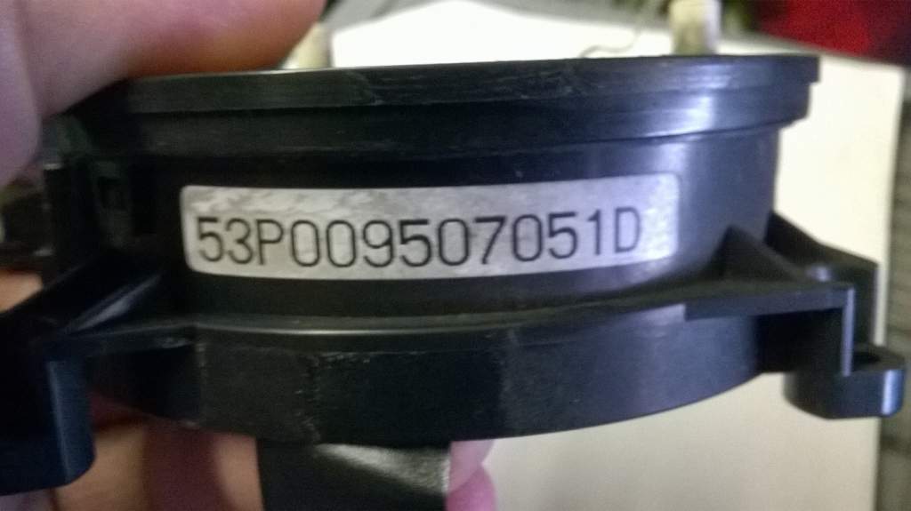

The breaker is a 1990/G non-turbo auto, does your one have a part number on it?
I have one of those off my 95 na, but as said that is an airbag wheel adapter (which mine was) , not sure if i broke it taking it out though, so will need to dig it out the garage

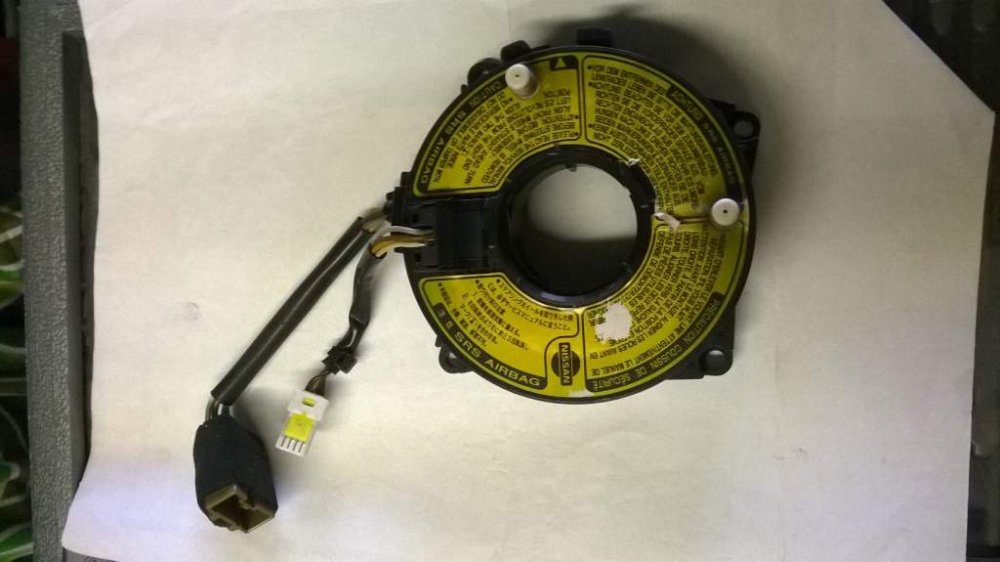

You say broken slip ring causing horn not to work. These dont have slip rings, they have a coil of ribon cable

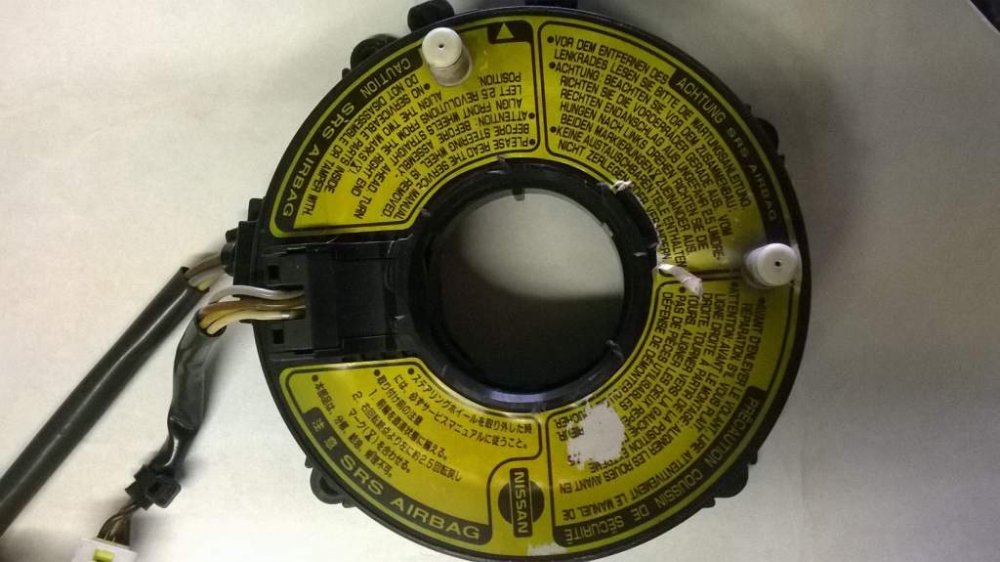

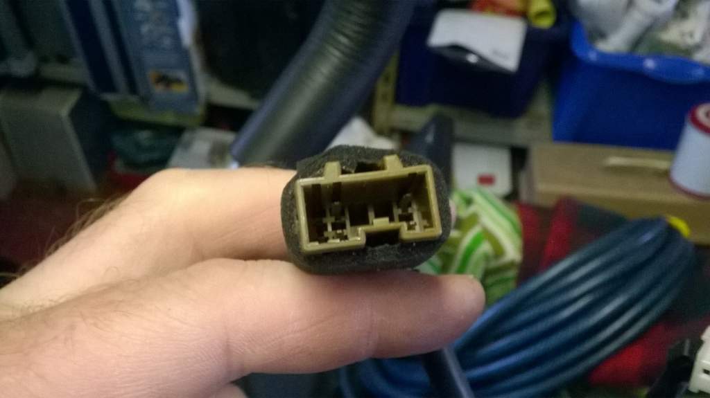

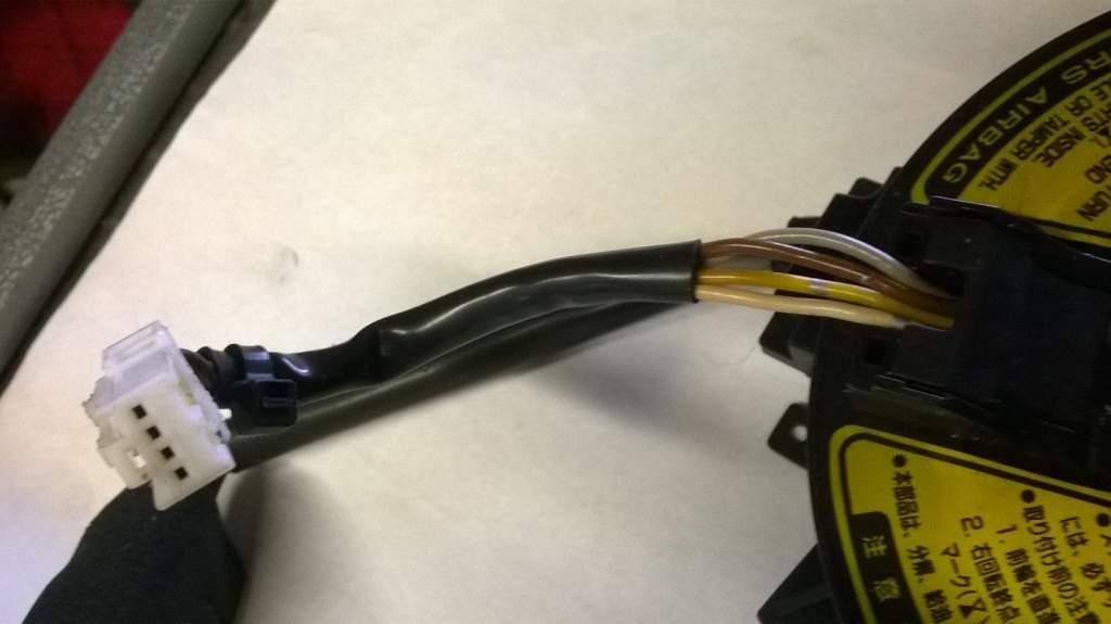

Here are some photos of the one i have. Note the top of mine lifts off allowing the coil of cable to jump out, cant remember if this is meant to happen and is held together in the car or because i broke it
Yours has less wires on one side, but you can always cut the spare ones off
[sIGPIC][/sIGPIC]
What yours does seem to have broken is the 2nd plastic peg, which i think is indicator cancelling ?
