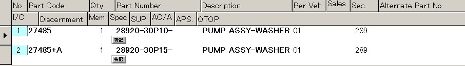

hi guys just had my windscreen washer pump fail, so i looked on courtesy nissan and got the part number 28920-30P10 which is for 4 seater front, however i asked nissan genuine who have advised me it's part number 28920-30P15 which lists as a rear washer pump for something else and is £20 cheaper, do the U.S. cars have headlamp wash? my car is a jdm so guessing nissan genuine have got it right using my chassis number but if anyone knows for sure please do let me know. got to wait 6 weeks to get it from japan anyway.

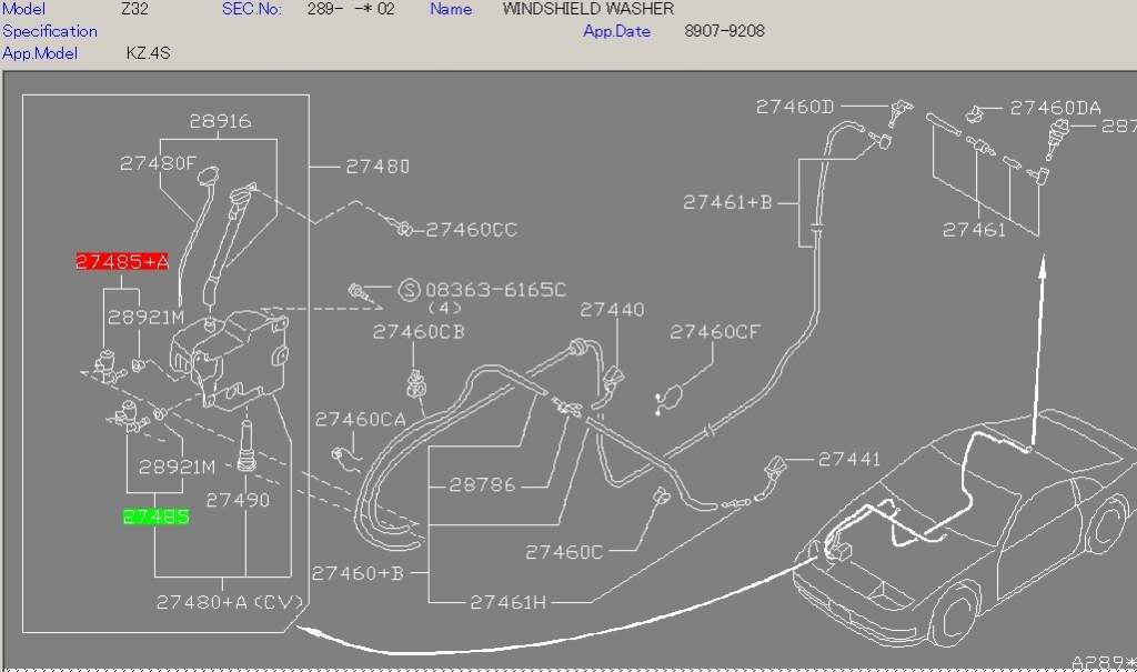

These are the part#'s for the LWB TT for front and rear washers. They are NLA in the states and may be in Japan.
28920-30P10 is the front windscreen washer pump, 28920-30P15 is the rear tailgate washer pump.
I've used this retailer in Japan to order hard to find parts:
http://jp-carparts.com/nissan/partlist.php?maker=nissan&type=132&fig=289*&part=2892030P10&page=2
http://jp-carparts.com/nissan/partlist.php?maker=nissan&type=132&fig=289*&part=2892030P15&page=2
brilliant thanks andrew i did just double check with nissan genuine and they have come back to me and said the supplier quoted on the rear not the front so all sorted and ordered now.
