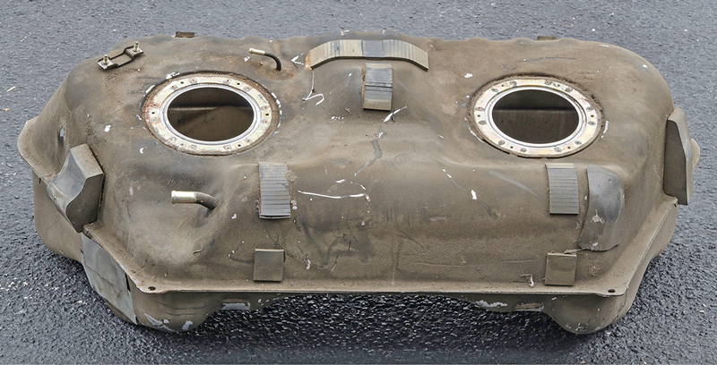

Andrew......MANY thanks for info AND diagrams.......Is the reason for two senders to eliminate fuel surge in the tank under sustained high "G" speed cornering.....Or is one for the needle reading & the other for the "Low Fuel" warning light.
I will fetch BOTH senders out & test them (thanks for your diagram again !).....Is the Variable Resistor a "sealed unit".....Or can I take it apart if it is "resting" ????

The shape of the tank in the 2+0 is effectively an inverted "U" so two senders are needed to measure the fuel level in each tub when
it drops below the middle section of the tank. There is nothing to stop the fuel sloshing from one side to the other on cornering.
Each sender measures the fuel level and the measurements are combined together for the fuel gauge. The "low fuel" warning

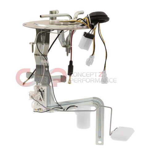

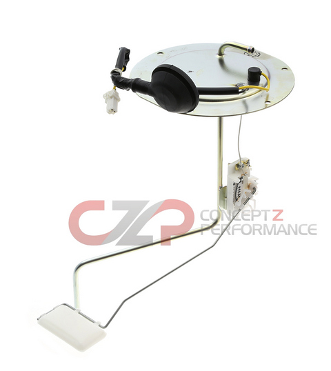

is a switch on the n/s sender unit. The senders look like this (the low fuel switch is the white tube in the left picture):
The switch in this case takes the form of a thermister which is housed in the white tube, these can be swapped out for a new one for about £20 - tell tale it's broke - your fuel symbol in the cluster does not illuminate (make sure you have a bulb fitted!), the trigger for this therefore..........the thermister becomes exposed to atmosphere when gas level drops.
