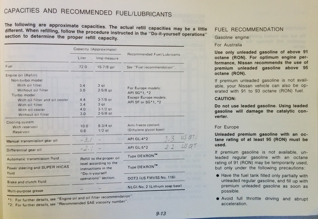

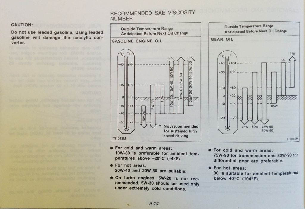

For your reference these are the two pages from the UK spec owner's manual for capacities and lubricants:
[ATTACH=CONFIG]112118[/ATTACH]
[ATTACH=CONFIG]112119[/ATTACH]
thank you , thats very useful info
