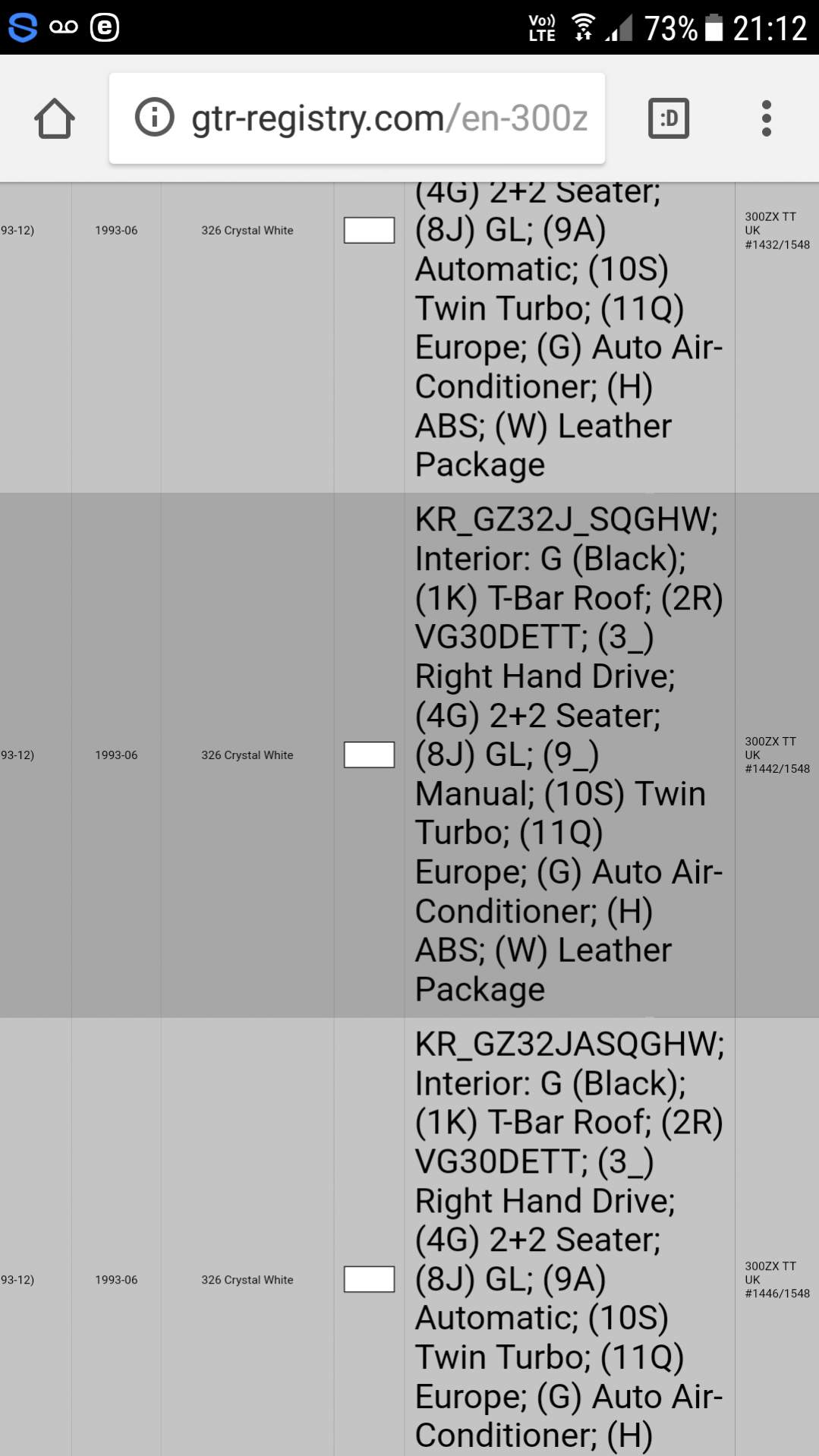

Thanks Andrew, I had a look but I must need to work out what month mine was produced as when I select it doesn't go to anything at all.
Mines a UK spec 1994
As your car is a UK spec you can look up the build date here (using the cars's VIN):
https://www.300zx.co.uk/forums/showthread.php?188643
Select the 300ZX TT UK RHD (1992-03>1993-12) and Show 1000 entries filters
Any problems let me know.
I must be a dim wit, found my vin, can't for the life of me find the build date thoScreenshot_20180501-211200.jpg
