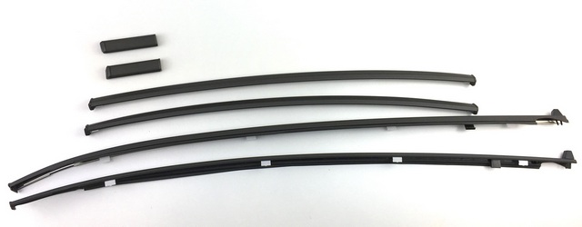

My Zed is a 1989 TT auto- now back on road after having been stood- runs fine etc but I have a paint? issue. The paint or powder coating has started to fail on the targa edges, the 3 inch approx piece of trim to the rear of the targas & on the stipp down the 'A' pillars leaving chrome on view.
What fixes are available for this- any advice most welcome.
The best fix is to replace with new OEM parts for a 2+2:
Windshield Molding - 72760-30P00, 72761-30P00
T-top Molding - 91784-32P20, 91785-32P20
T-top/Hatch Rear Molding - 73852-32P00, 73853-32P00
Edited by AndrewG
Qualification for 2+2 parts
Too dear- how come they are chromed then painted/powder coated?
As standard they are a rustproof metal substrate, without it, the trims would be even more fragile. It's not chromed, they're likely to be of stainless construction hence the pricing.
