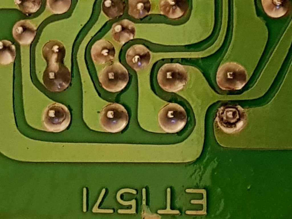

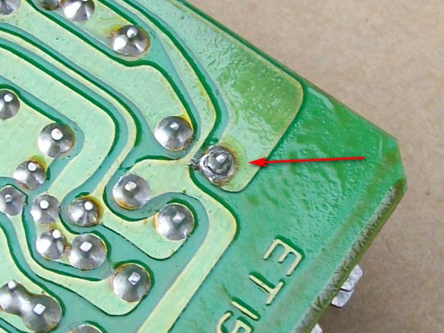

Easy fix here >>>>
https://www.300zx.co.uk/forums/showthread.php?128022-power-window-repair-(inside-out-feature)&highlight=window
In the meantime if you need to raise your window, with ignition on hold the up button and bang the door inside centre with the palm of your hand whilst keeping the window up button pressed, most times the banging of the door makes a temp connection to get the window closed.
No need to totally remove the door panel, just unclip the bottom and ease out and you can look up inside and get to the module.
