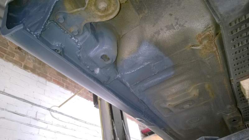

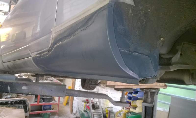

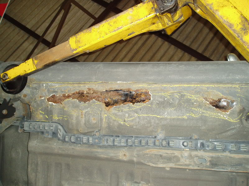

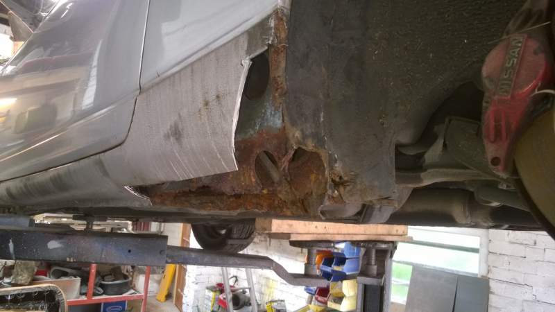

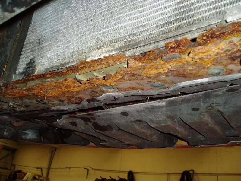

Ok already mentioned but rust and corrosion is the MAJOR killer now to these cars, although repairs can be of course done its all about how serious the rust is and what the prospect of keeping the repair cost in an affordable budget that befits the rest of the car and the purchase cost.
Many more mechanical things to look out for and sure you will get advise about that, but No1 is rust now, take a look at the rust levels and the amount of repair fabrication, welding and painting that goes into it, and these pictures are far from the worse we have dealt with, one other thing is, these photo`s are 9 years old !!! image that even if repaired then even to a good standard the chances are its back !!
Just be careful and inspect all you can, have fun and keep it real financially and you will enjoy it.
