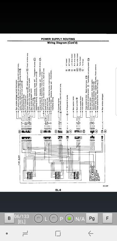

I have a problem with the gauges / clocks all of a sudden.
Issues appear to be:
RPM - dead, not working at all
Oil pressure - dead, not working at all
Boost - going all the way to the righ (+14)
Consult port also seems to no be working all of a sudden too.
The speedo was already dead, which is what I was looking at, I basically plugged another set of clocks in while the engine was running when this happened. Same issue on both sets of clocks. So I'm guessing I perhaps blew a fuse or something. Does anyone know if there's a specific fuse that these sit on?

Found it and all back to normal.
10 amp 'meter' fuse in case anyone is ever looking for it. Dis find this page in the service manual quite useful for what fuse goes to what
