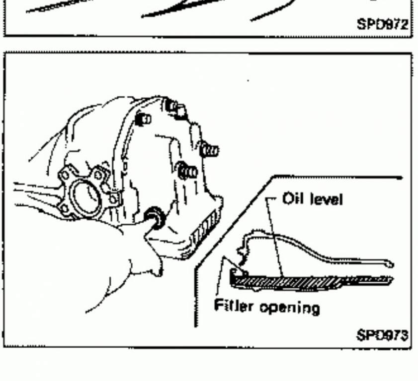

If anyone have a picture of this fill hole please send it I even check on the sarveic manual didn't find it
Sent from my G8142 using Tapatalk
[ATTACH=CONFIG]110155[/ATTACH]
As Jeff said, its on the side, and the same as with the drain hole, you use a square socket drive in it.
This is the drain hole right?
Than im good i open that one but to much oil came from it never open the one on the bottom i remove the exhaust and open it im wandering whay is to much oil came from it i jack the car and fill this hole tell the oil came out
As Nissan reccomend in my post above, it should only be up to the fill hole.
I imagine either it was jacked up and overfilled or not level when you opened it.
