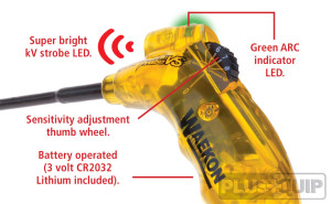

No harm in giving it a shot.. what's what you say new GTX2860's are essential maintenance items too? must tell the mrs.
What does that set you back roughly? Looks like a decent bit of kit! Did you ever find yourself upgrading coils or not bothering Jeff?
Been some years ago now, £60 seems to be in my head, the coil packs are very robust electrically but can fail if mishandled. Splitfire coil packs look real nice but only ever fitted one set for a customer as a special order and we're over £300 and there was no difference that was perceivable.
Jeff
Price has near doubled now I think... I'll do some investigation first and see if I can get a hold of one of those testers. Knowing my luck it'll be something terminal haha. Good excuse to rebuild ;-)
