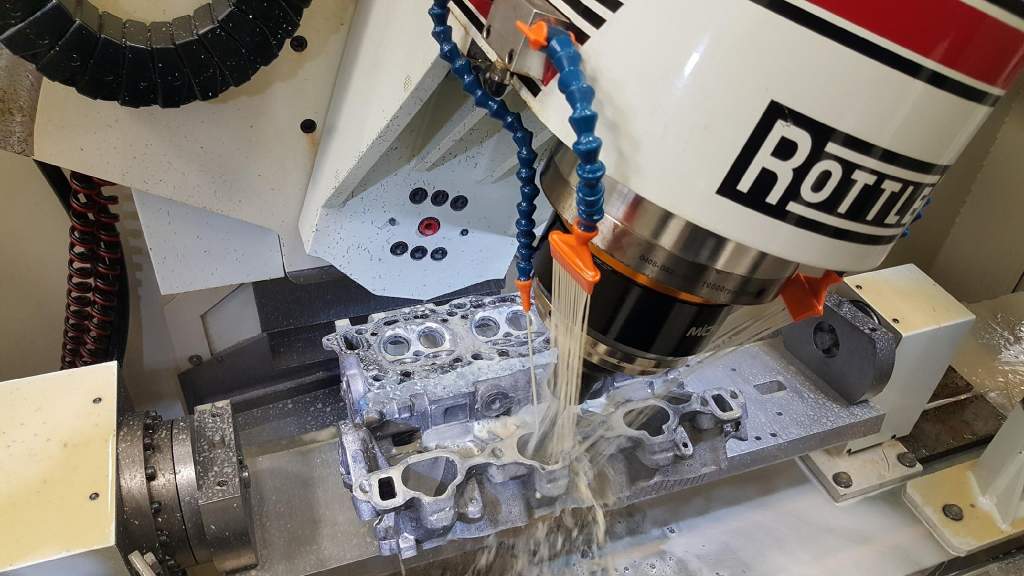

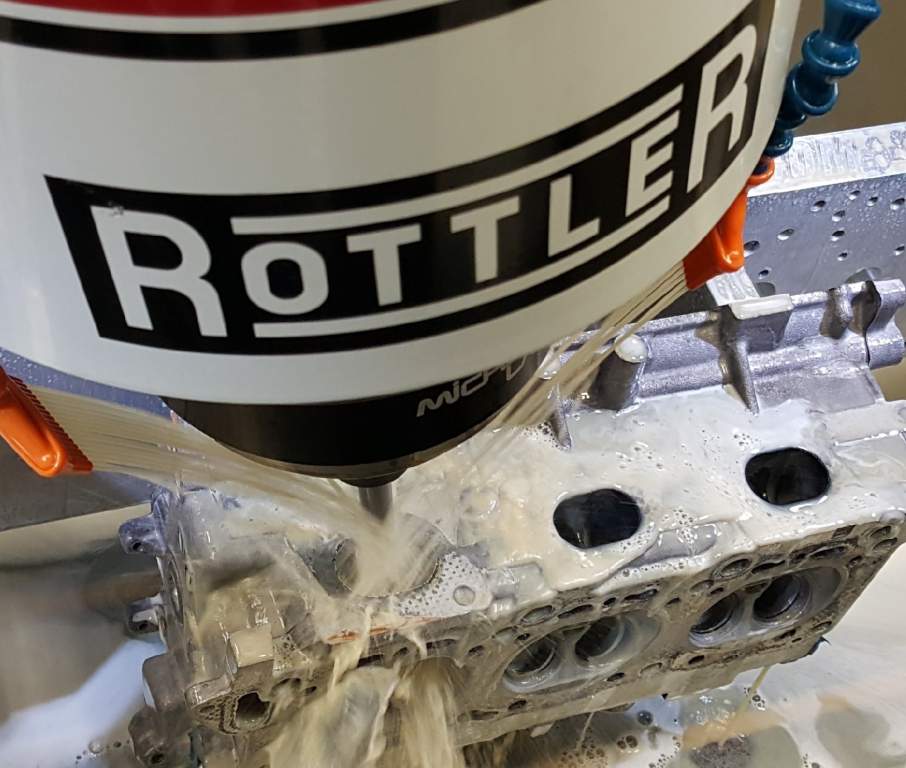

I’m hoping for a video call with Mitch this evening to try and get a firm date. The unknown is the heads as they’re CNC machined by an outside company..... and they’ve had them for 5 months!

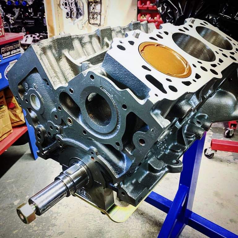

FINALLY, it’s in the assembly room

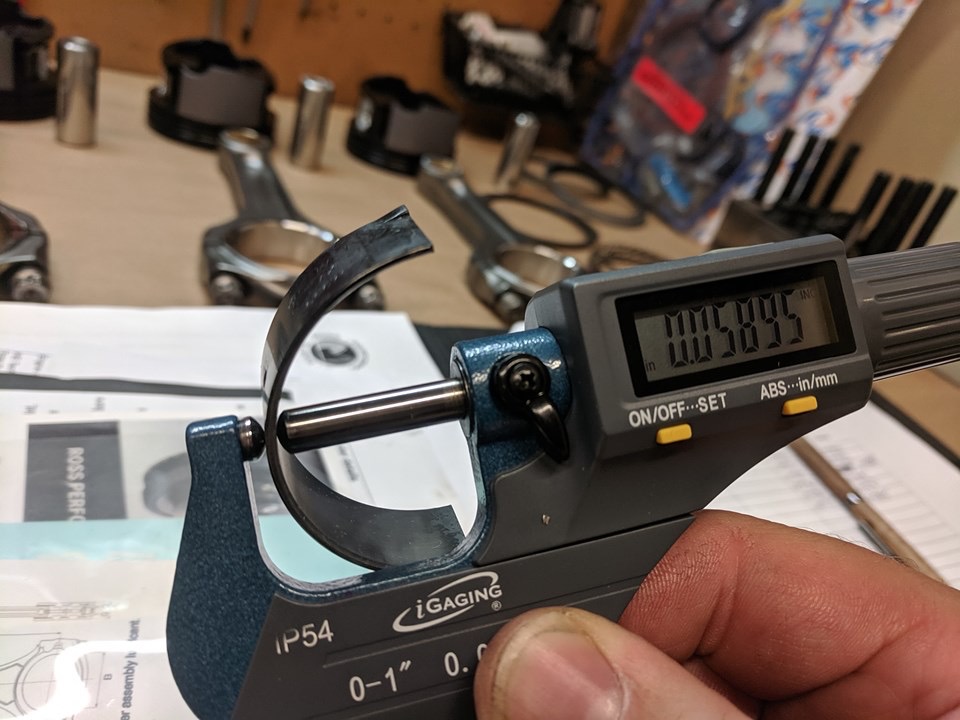

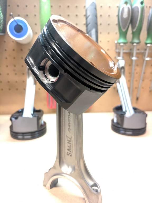

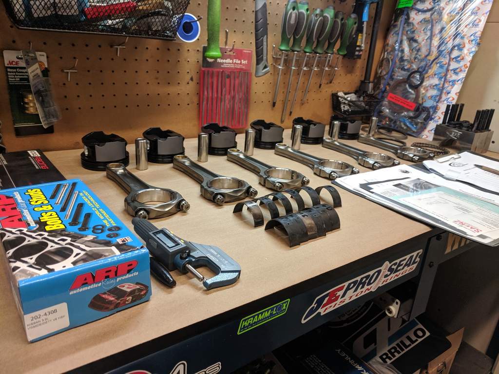

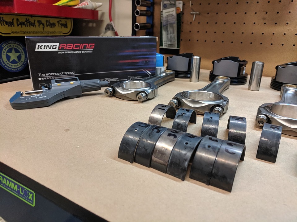

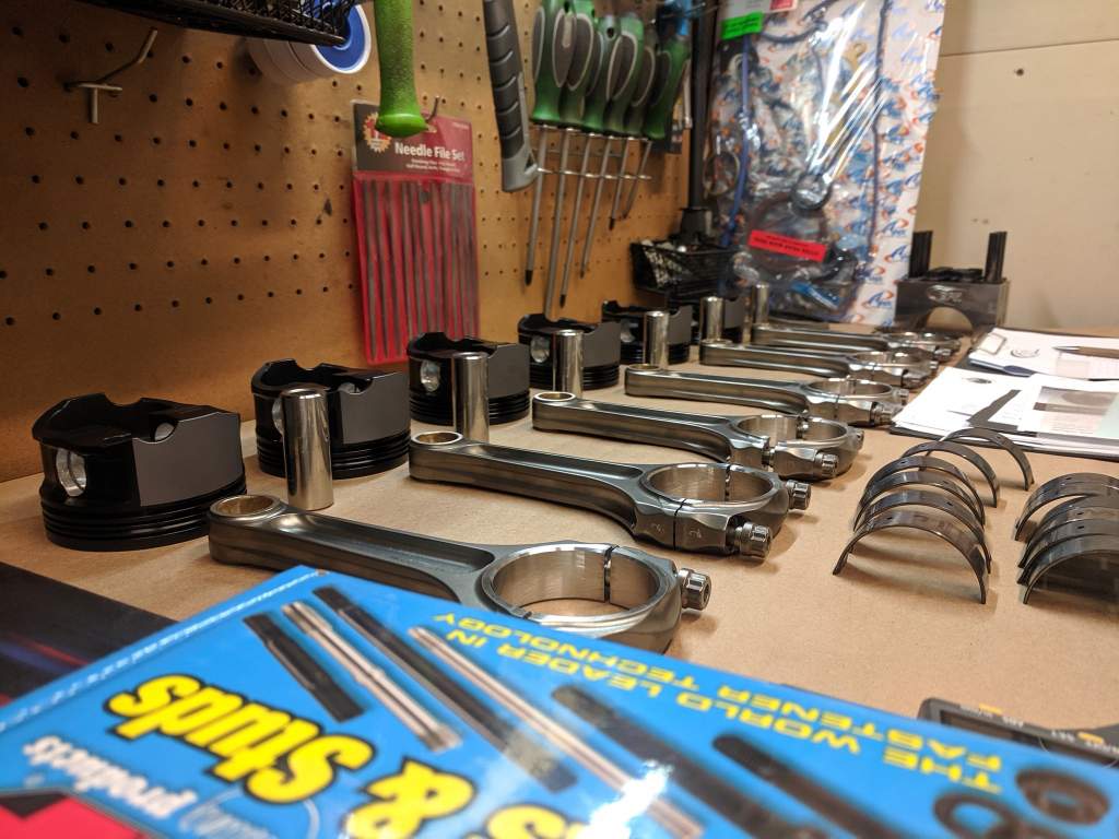

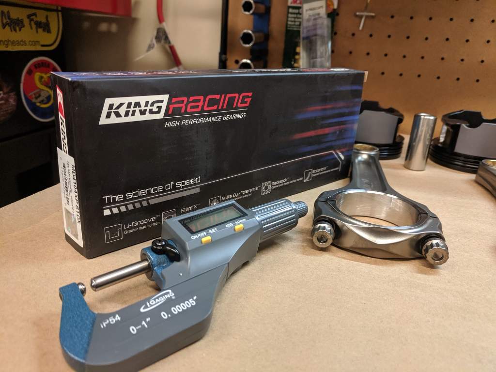

And an interesting comparison between the Wiseco/Eagle combo vs CP/Saenz combo.
Wiseco 88mm piston and Eagle forged rod weigh 863 grams combined (the setup I had on my previous build)
CP 88mm piston and Saenz Tri Beam forged rod weigh 754 grams.
Total weight saving of the internal rotating assembly: 0.65kg!

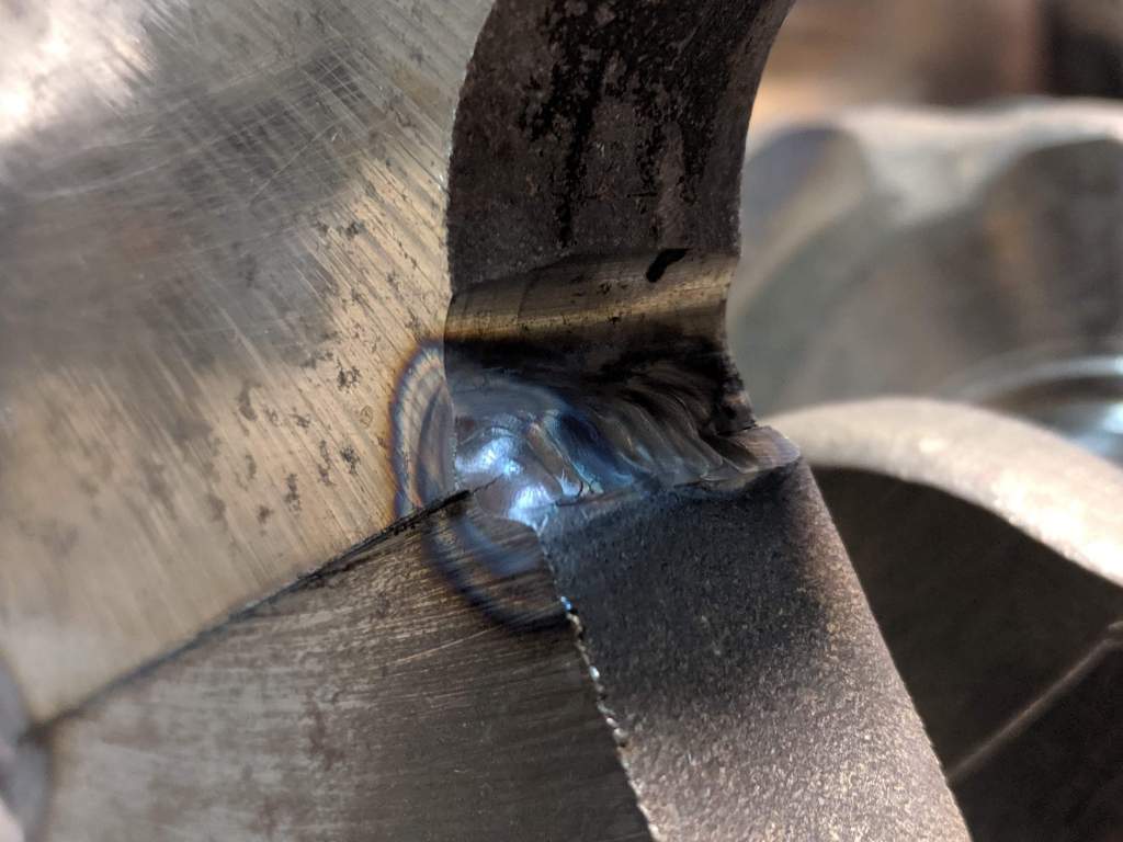

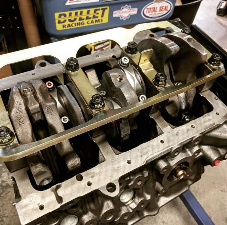

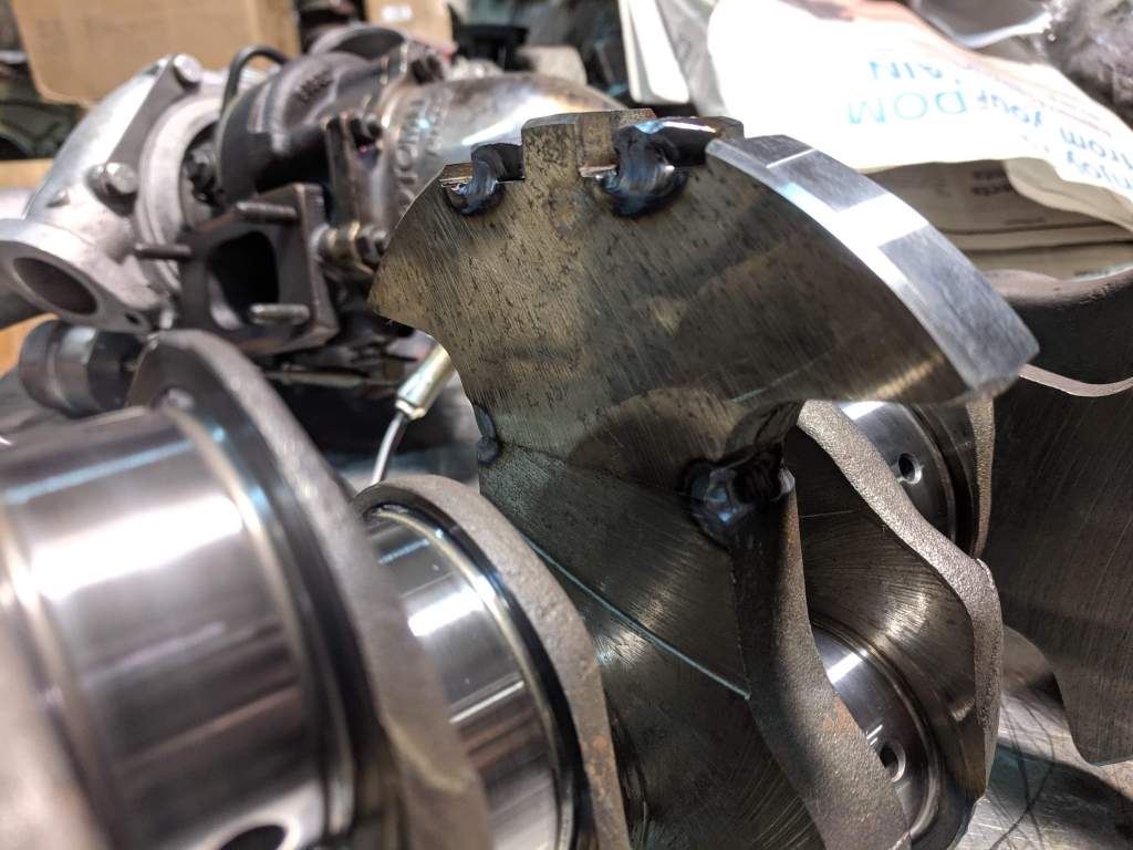

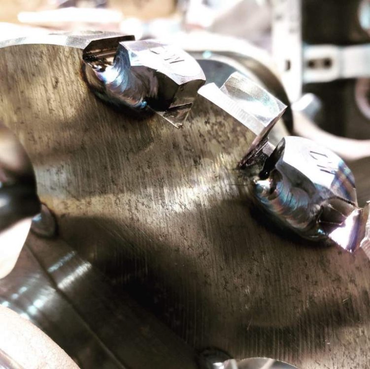

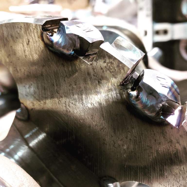

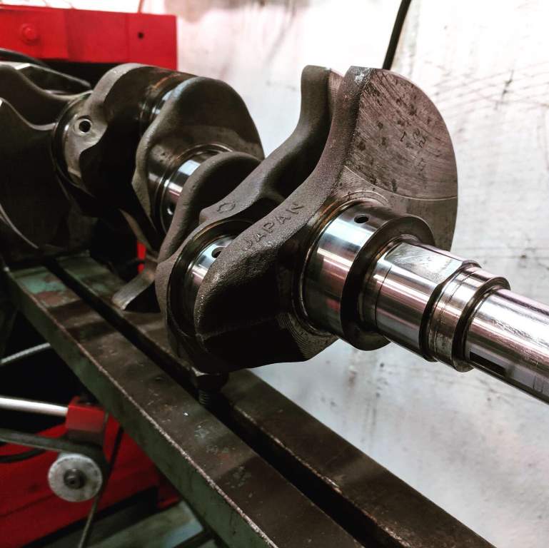

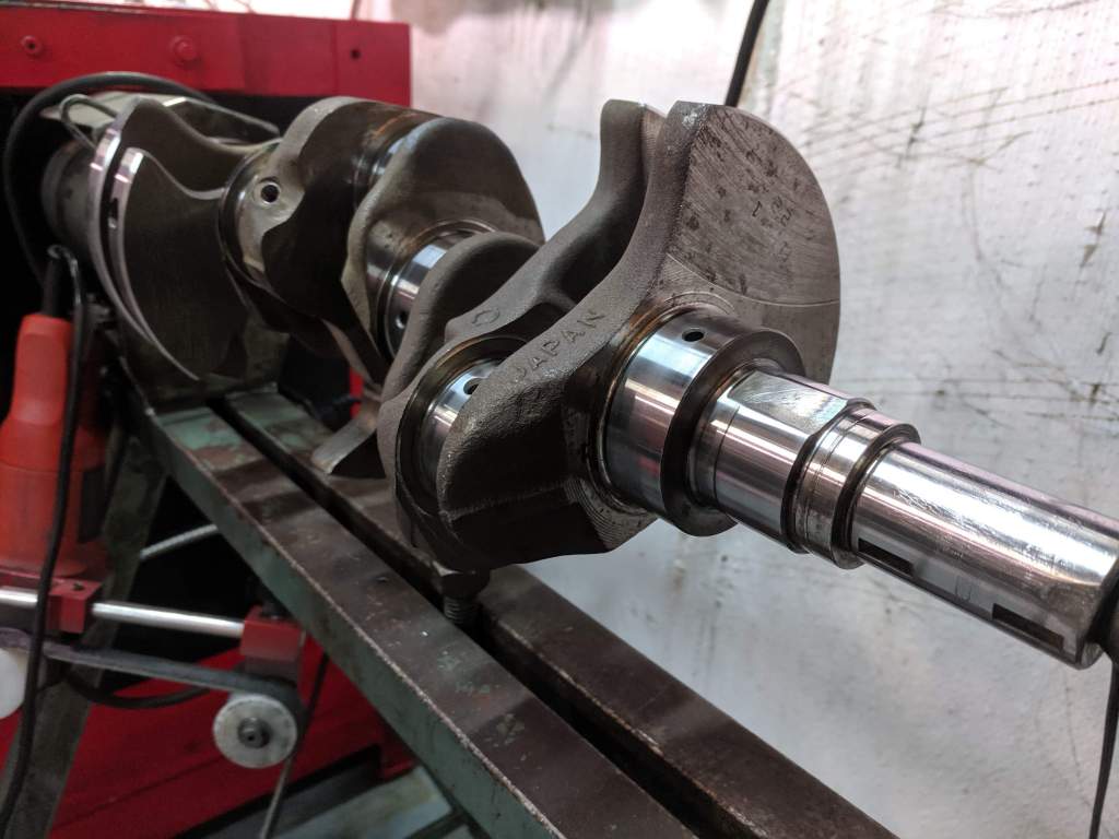

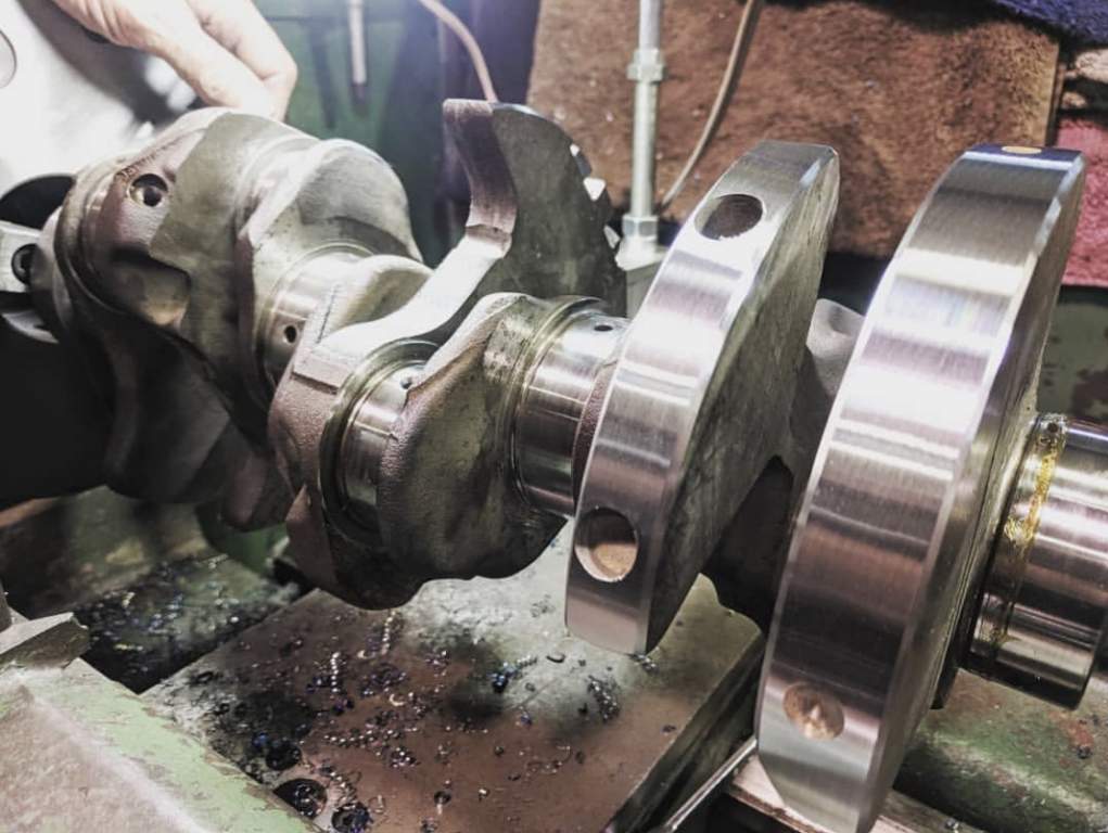

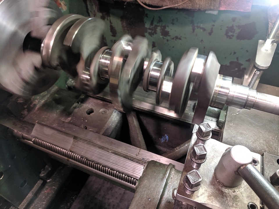

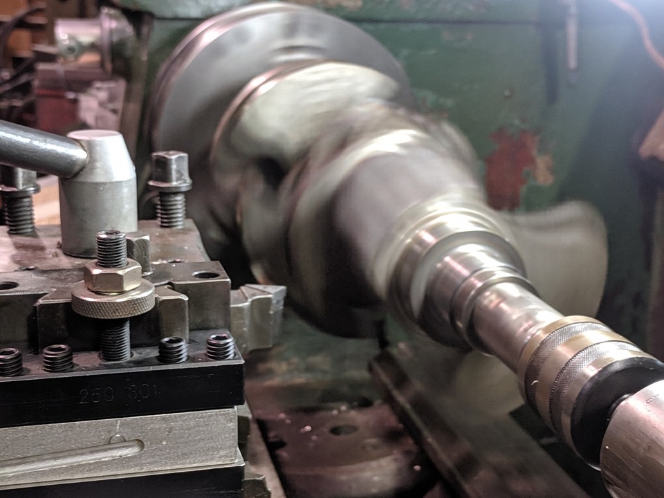

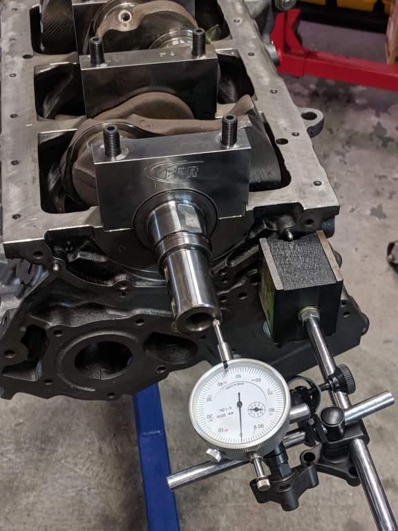

Crank has been modified, machined, welded and balanced and bar a final clean is good to go

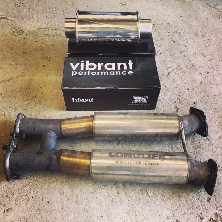

Firstly I’ve ordered a few parts. The Improved Racing thermostatic oil filter relation kit and a pair of Vibrant Ultra Quiet resonators (which will replace the useless LongLife resonators in my H pipe). I think the only bits I need to order now are a new oil coolers, some dash 10 braided hose and some AN10 fittings for the remote oil filter and cooler lines

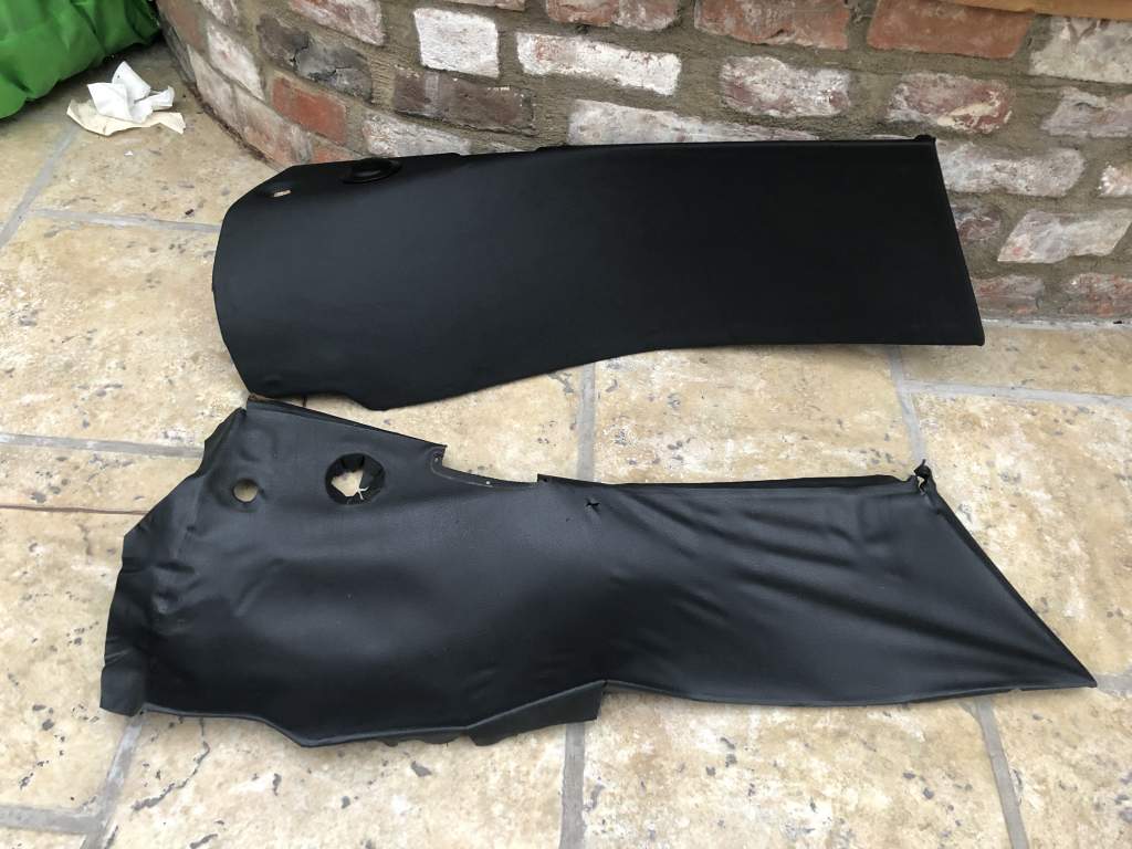

This evening I also finished my first attempt at retrimming some interior parts, the rear quarter panel vinyl sections. I don’t think they came out too badly consider my inexperience. The colour is a tiny bit darker and the faux texture differs slightly, but it’s close enough that I doubt anyone would notice

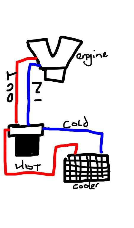

Excuse the crude drawing

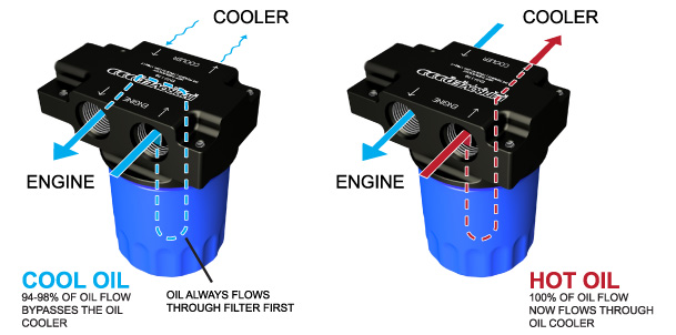

In short the OEM oil tree has been replaced with a BDE oil tree plate. Hot oil is fed along -10 line to the Improved Racing remote filter head. That will be mounted near the AC dryer. I’ve removed the OE cooler lines to give me more space
While the engine warms up, oil is passed through the filter and returned back to the engine bypassing the oil cooler. Once up to 185F, the thermostat directs all the oil through the filter and to the oil cooler. From the cooler, back to the IR filter head and back to the engine.
Sorry, I misread your original question. I’m using a Wix filter that has one built it. However, as I thought more about the bypass issue I realised a couple of things. 1) I’ll be changing the filter every 12 months or 3000 miles anyway, which isn’t going to be enough time to block a filter to the point where I’d need the bypass valve. 2) if I do block a filter that quickly, the engines likely toast anyway so a bypass valve wouldn’t offer me any extra protection

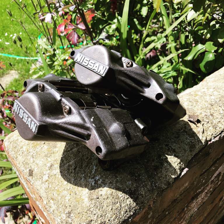

On a positive note, I got back rear brake calipers back from refurb. As I suspected, I had a couple of sticky pistons due to a build up on aluminium oxide. So after an ultrasonic clean and polish of the pistons, new set of seals they’re good to go
I’m hoping, at some point next year, to sort my rear brembo conversion out, but in the mean time these will do

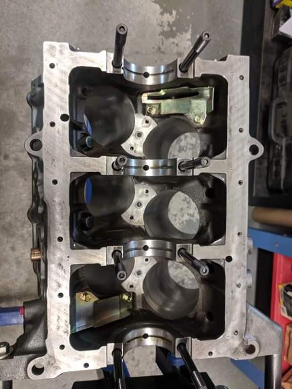

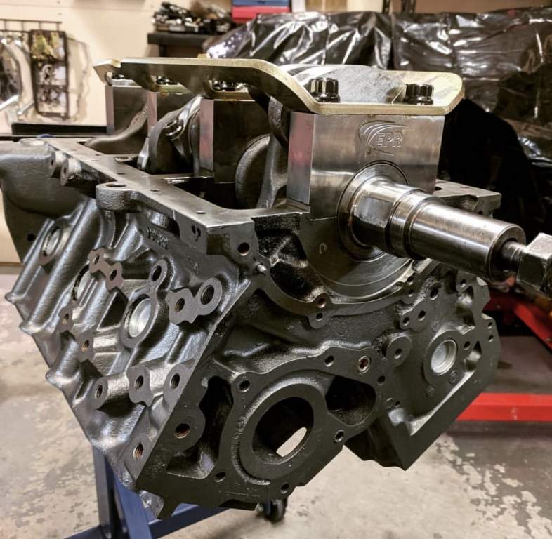

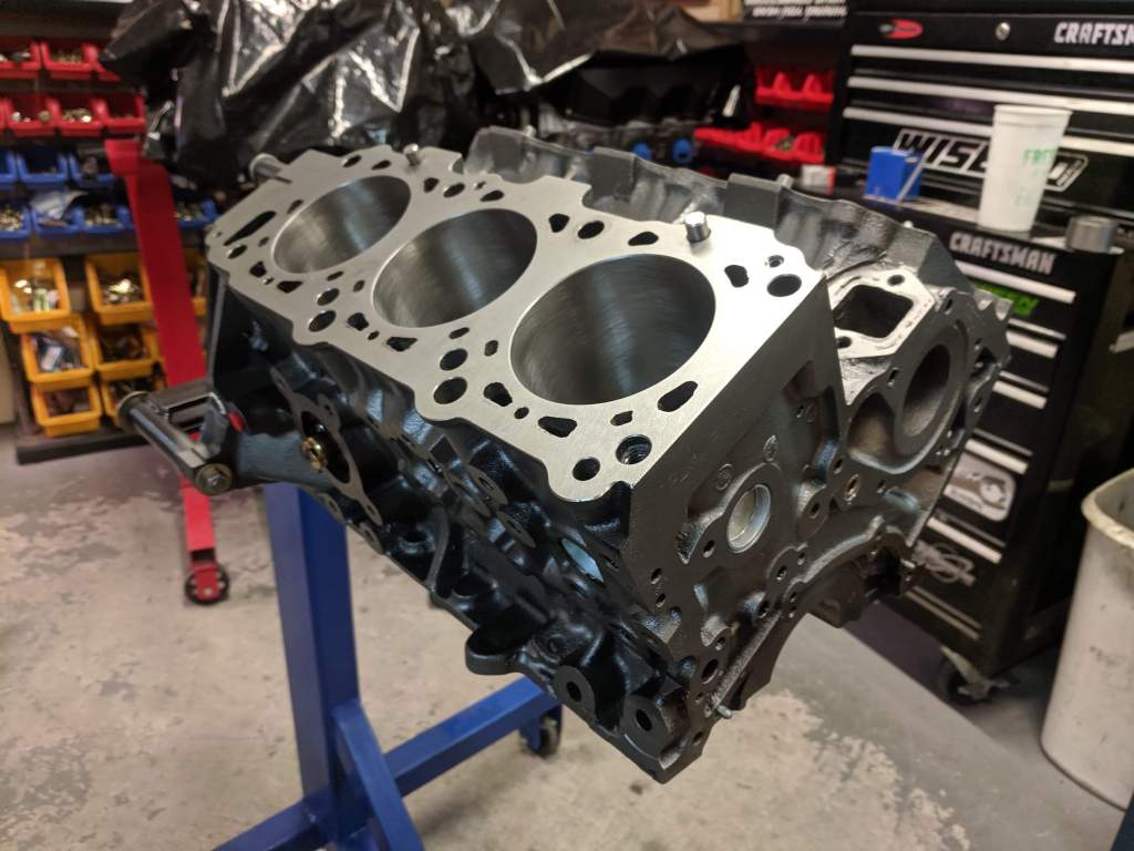

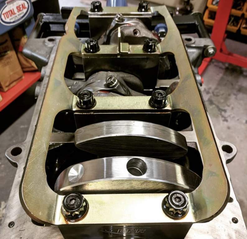

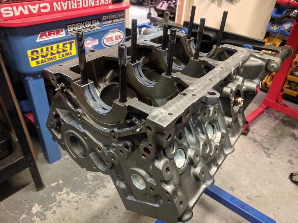

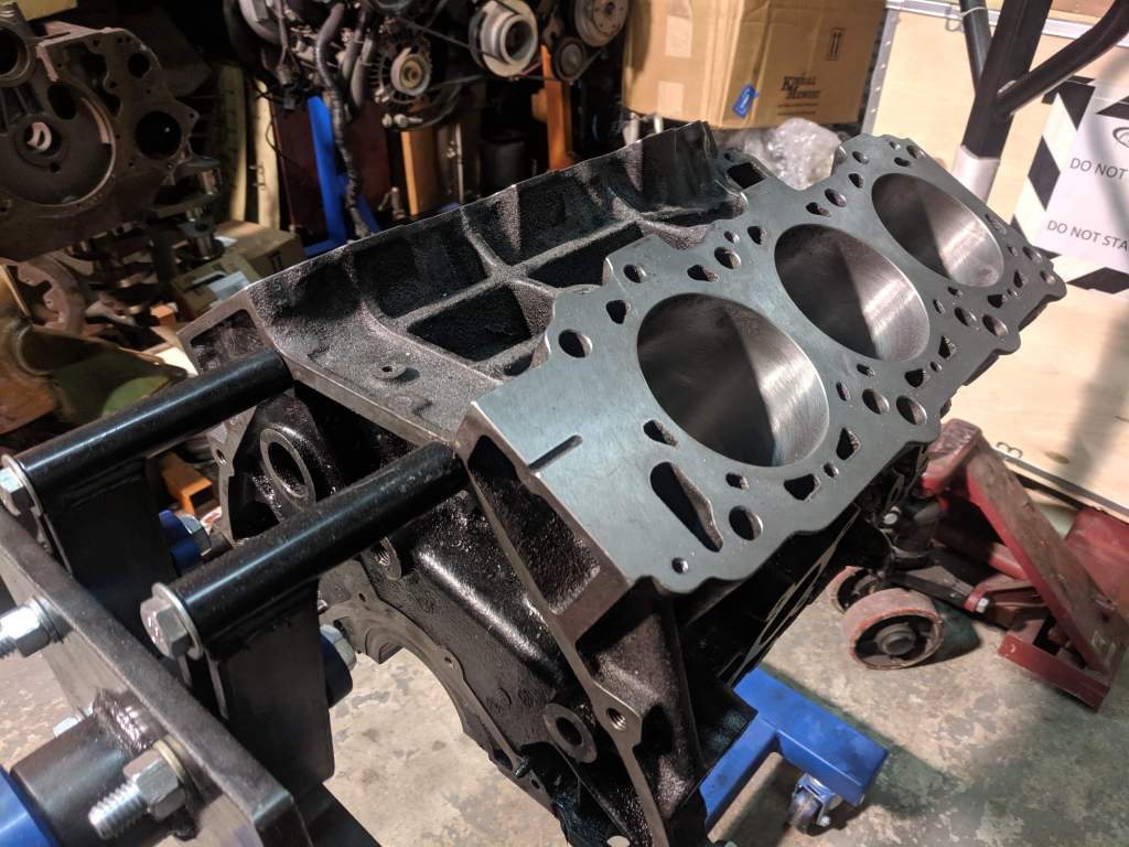

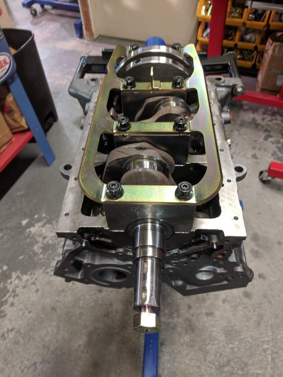

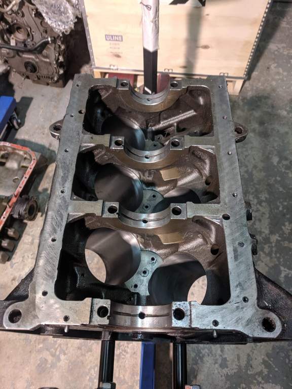

On the engine front, the block has had its final debur, clean and paint (not pictured) and assembly will start later today.
A couple of interesting point of note:
Oil Squirter: as you can see in the bottom pic, they’ve been blanked off. Why? Due to the coatings applied to the pistons, that spray of oil is not needed. That mean less parasitic drag on the internals and reduces windage and potentially less crank case vapours.
Block oil restrictions: The OE press in restrictors have been removed and replaced with removable items (to assist any future cleaning should the worst happen)

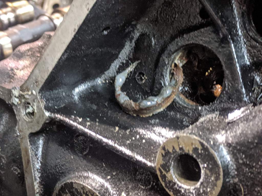

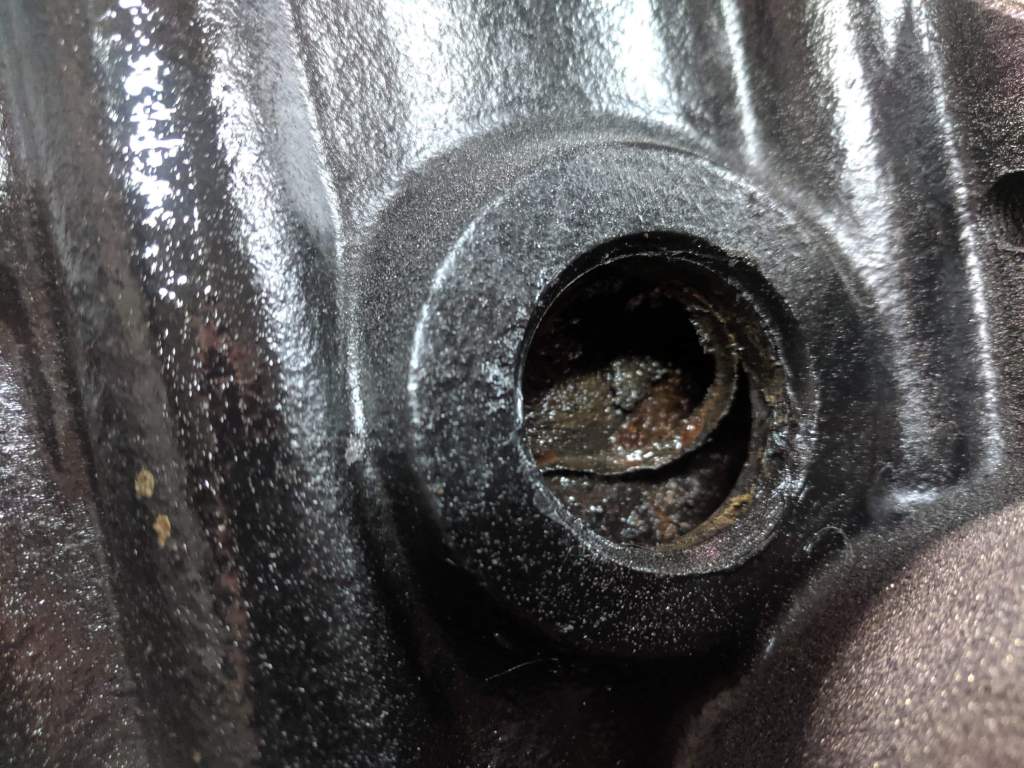

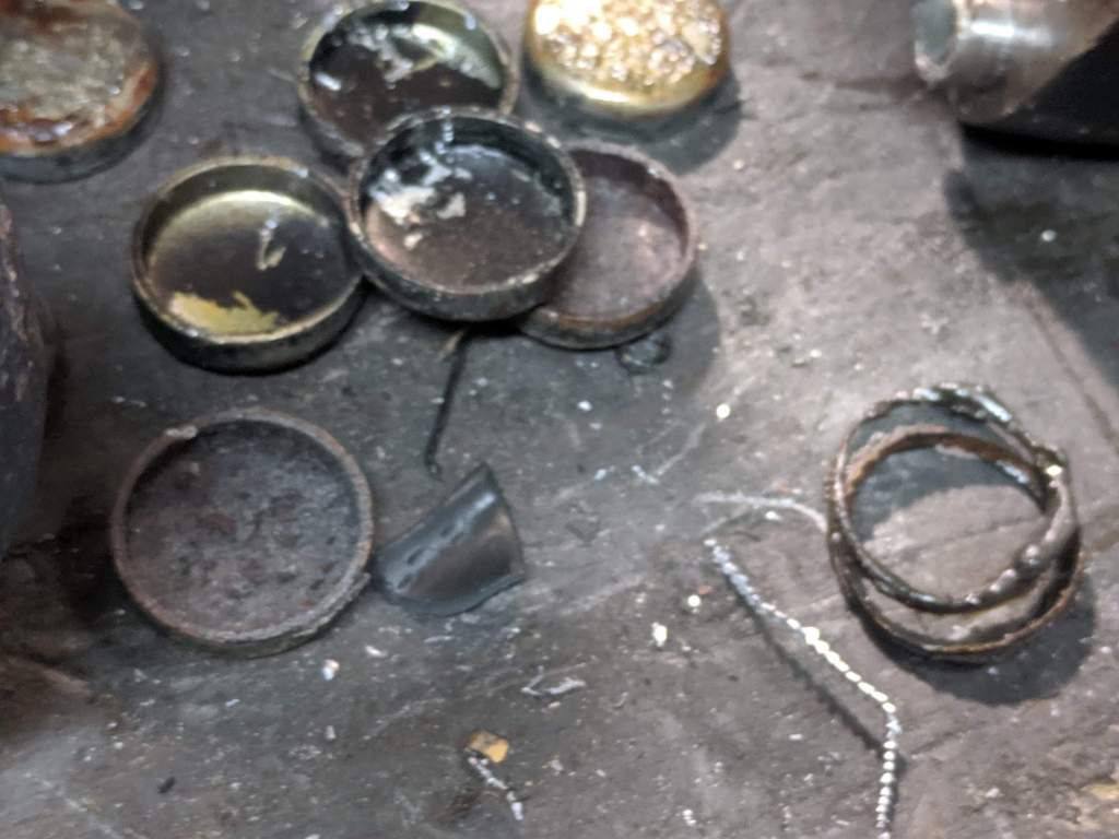

Freeze plugs: I was gonna smacked at how much junk was hiding behind them! Just shows how much cleaning is truly required on an engine rebuild

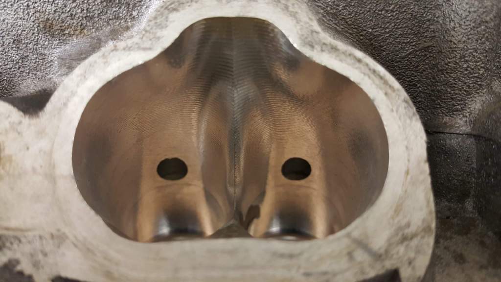

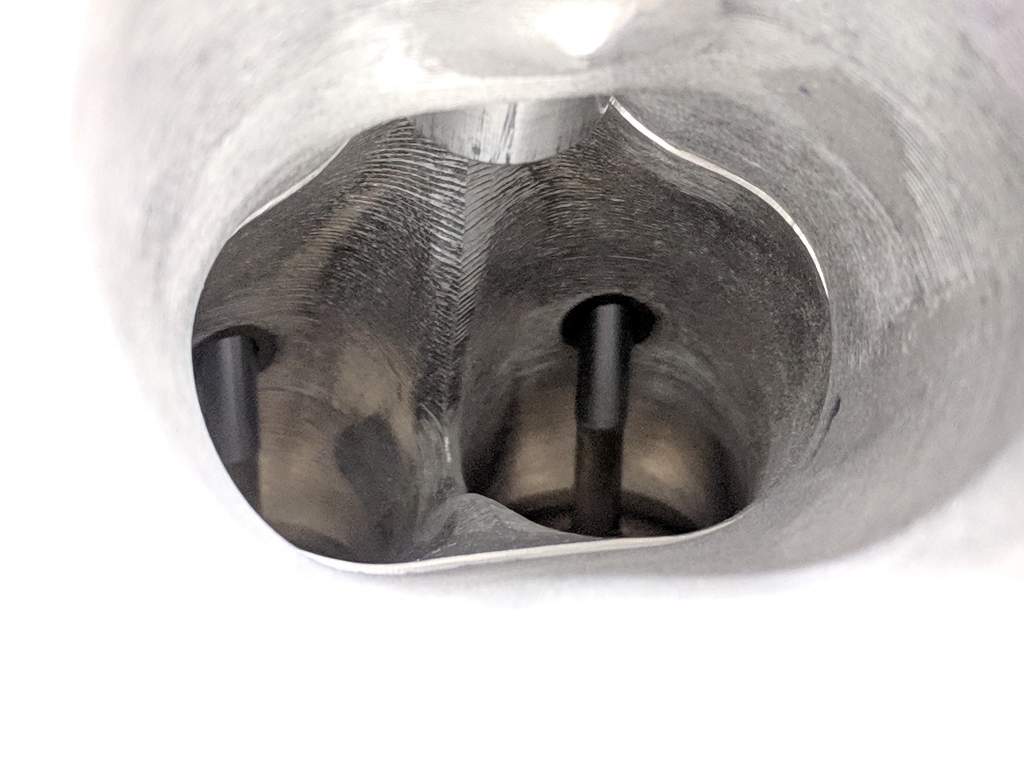

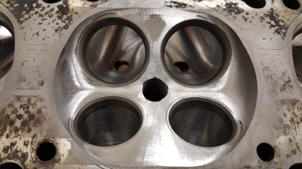

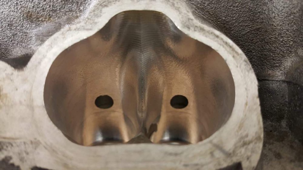

Lower Plenum has now been ported, with the injector entry altered for better dispersion(you can see before porting on the right hand port and after on the left hand port) It's completely matched to the cylinder head ports for optimal flow. The heads have been shipped back to EPR and should be there on Monday for the valve seat cut and assembly
Edited by nickz32

New Vibrant Ultra Quiet resonators turned up today... hopefully they’ll save my ears!

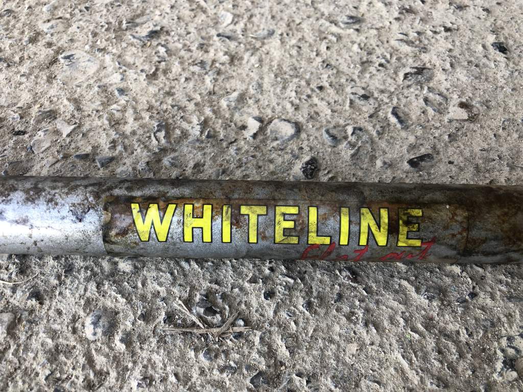

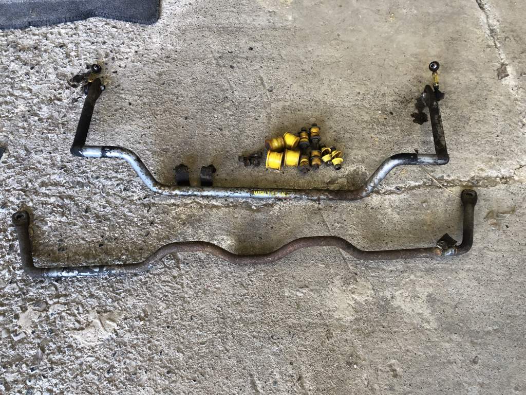

A slightly unexpected purchase aswell. Saw these on a breaker near me and snapped them up! They need a refurb, but will add to what will eventually be a full Whiteline suspension package

So the heads are having their valve seats cut at the moment so should be with EPR beginning of next week. Then it’s machine for cam lobe clearance, debur, clean and assemble. After that, front of the engine goes on so it can be timed up. The turbine housings need porting and the hot side parts need ceramic coating.

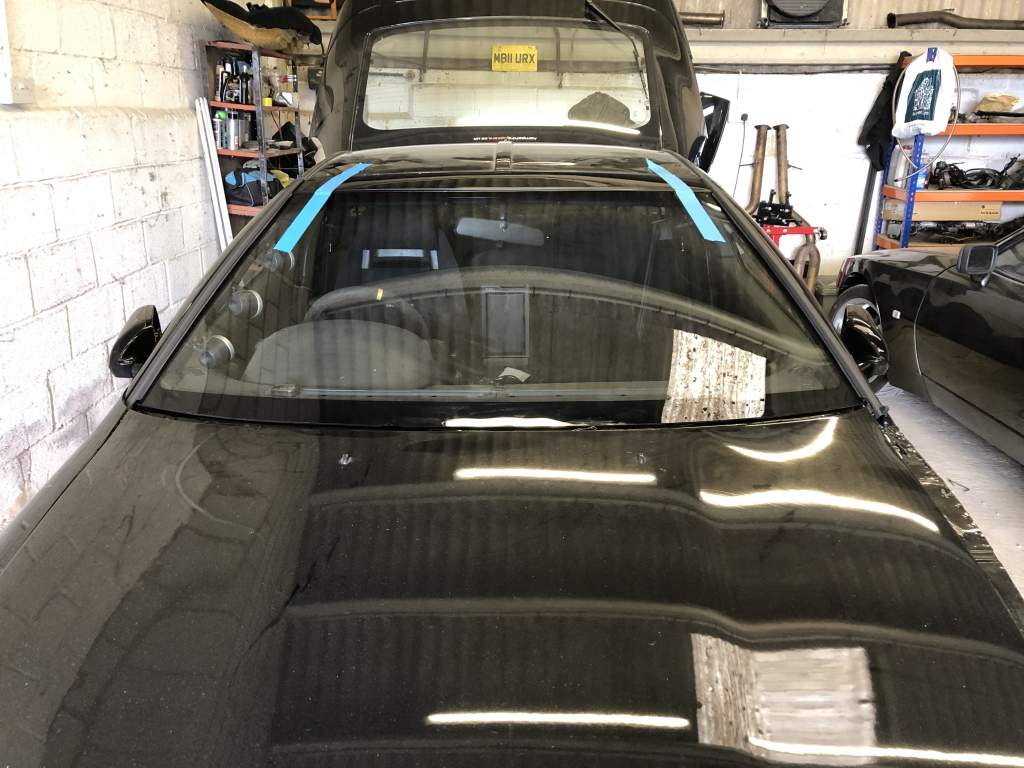

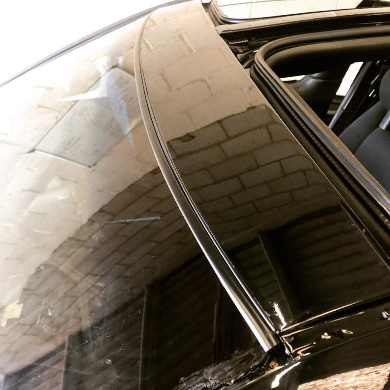

Well after getting fed up with 1st Direct Windscreens refusing to admit fault at incorrectly fitting my windscreen, I finally sorted another company to come to my workshop and reinstall my windscreen properly, with the Nissan upper windscreen moulding
Annoyingly, I appear to have misplaced the little white block clips for the roof part of the side mouldings. Bloody annoying when that happens!
