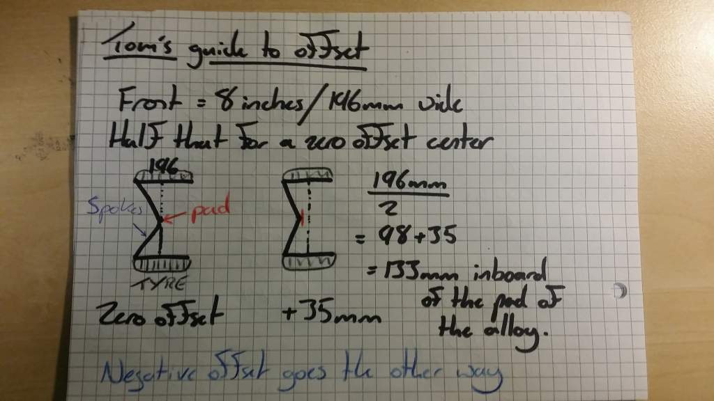

Give me half an hour. I'll get a pen and paper :) I have been meaning to look into how offsets work... for my stance build! :lol:
JoelyP, AndrewG or FunkySi should be able to help
I currently have a 8.5" wide wheel on the front which is ET35. I've fitted a 20mm spacer to bring it flush with the arch.
My rears are 10" wide and again ET35 and they sit perfectly flush.
Based on that, I'd say that you'd need spacers front and rear to make them flush, but there shouldn't be any issues with caliper clearance unless you have bigger brakes fitted.
The pad is the face on the inside of the alloy which mates flat against the hub.
Standard Wheels
7.5 +45 offset 7.5 inches = 183mm/2 = 91-45mm = 46mm from the pad to the outermost point of the rim.
8.5 +35 offset 8.5 inches = 208mm/2 = 104-35mm = 69mm from the pad to the outermost point of the rim.
Yours
8 +35 offset 8 inches = 196mm/2 = 98-35 = 63mm from the pad to the outermost point of the rim.
9 +35 offset 9 inches = 220mm/2 = 110-35 = 75mm from the pad to the outermost point of the rim.
So they are going to be 17mm wider on the front and 6mm wider on the rear.
The hub centre bore is 66.1mm
Your wheels are 72.6mm and 73mm
So you will need hub centric spiggot rings otherwise the wheels will be slack around the little lip on the hub.
Someone shoot me down if that is all *****cks. Please check my homework! :lol:

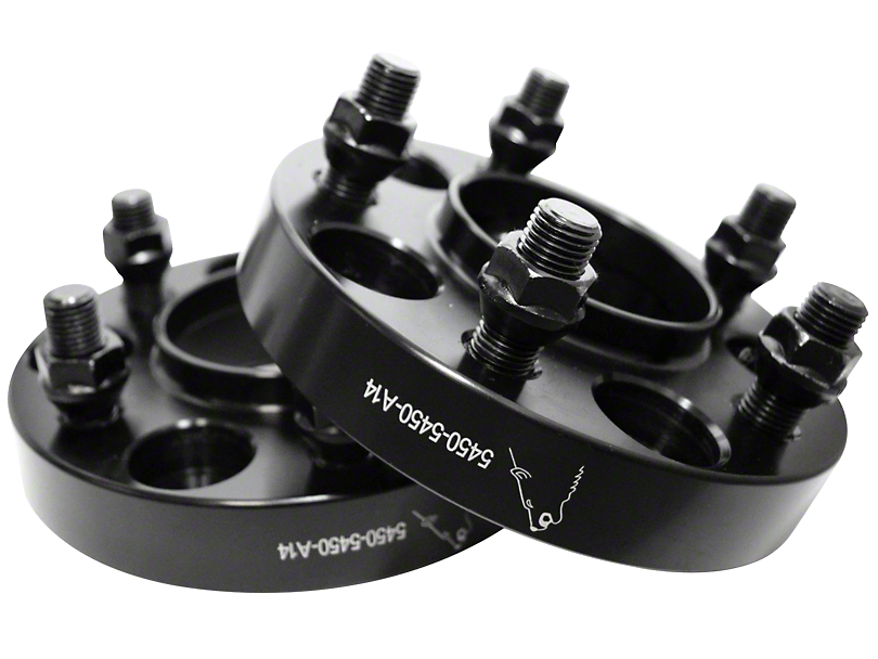

If I go to the spacer route at what point do I have to change the studs?
They are very like mine except mine are 18" I had to put 25mm spacers on the front to bring the wheel out level with the wheel arch. If you use hubcentric spacers then you don't need longer studs.

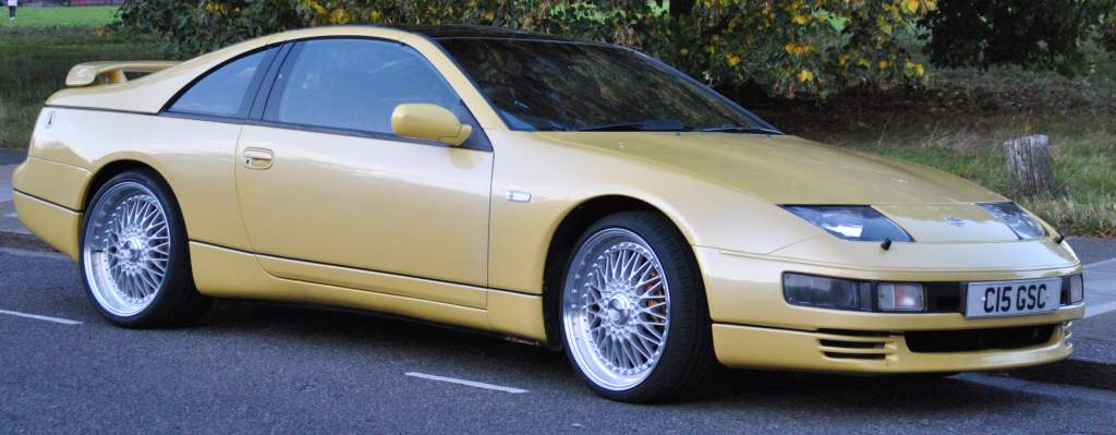

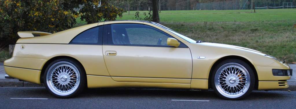

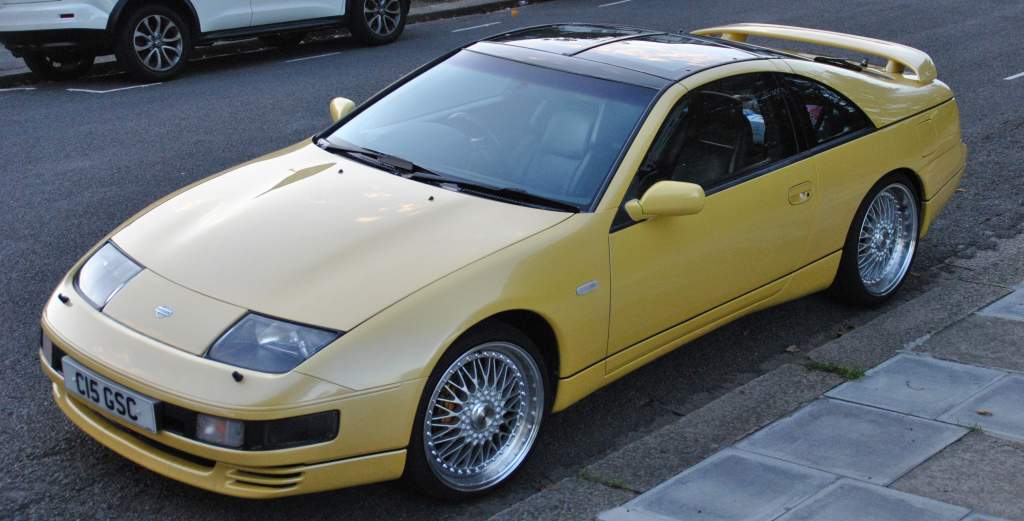

Scott...I bought those very wheels for my Zed....19" Calibre Vintage from a company called 'Carnoisseur'....they too were a little concerned about caliper clearance at the front...and sent me a single wheel to try before sending the full order!
It was close...but they do fit :yes: ....(over standard calipers)
The specification of my wheels are:
8.5 x 19 front
9.5 x 19 rear
Finish: Silver with Polished Rim
Front Offset: 35
Rear Offset: 35
PCD: 5x114.3
Quick Code: W544
I haven't used any spacers and think they sit pretty well
