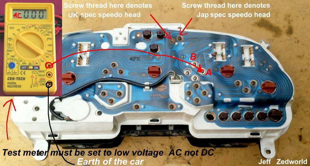

Given the signal goes directly from the speed sensor to the speedo cluster and that in general the speed sensors are robust and do not suffer common failure if the speedo stops working and the steering weights up after the problem is with the speedo not producing an output signal, this is very easy to check for, with the cluster removed but still plugged in, the input and output AC 1 to 5 volt signal can be checked, jack up both wheels just clear of the floor by an inch or so, make safe. Start the engine and in first gear or drive in auto`s allow the engine to tick over in gear so the wheels are turning slowly, now with a meter set to ac voltage check input and output, this of course will only work out of the problem is present.

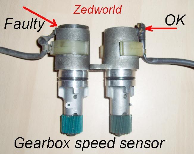

Very good post Jeff, thankyou! I didn't realise the VSS went straight to the speedo, then through to ECU. What's the approx VSS location on the gearbox, if it's easy enough to remove there's no harm checking for mechanical wear etc. It does indeed have a converter, the previous owner said he's been through 3 guage clusters and each one had the same issue, with and without the converter in toe. Are those rare-ish 300kph Jap speedo's likely reliable? Reading in kph doesn't put me up nor down.

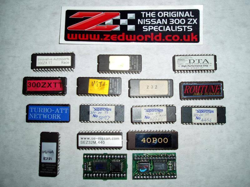

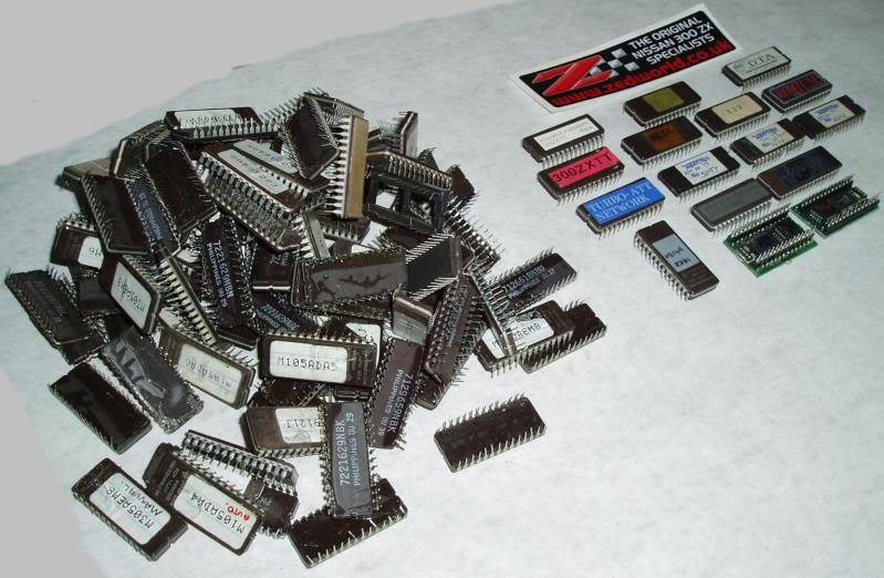

Jeff didn't you used to do those generic ECU maps on a return basis or am I thinking of the wrong guy? :)

Here is a picture of the gearbox showing the speed sensor>
yes I did used to do generic chips but in the workshop only.

Ah - much obliged! Haha, I used to have one in my old Z32 TT, my current one has M's FBC electronic boost controller which has a piggy-back into the stock ECU. I'm damn sure it doesn't run half as stout as my old one with 0.9 Mig Tips and your ECU.
