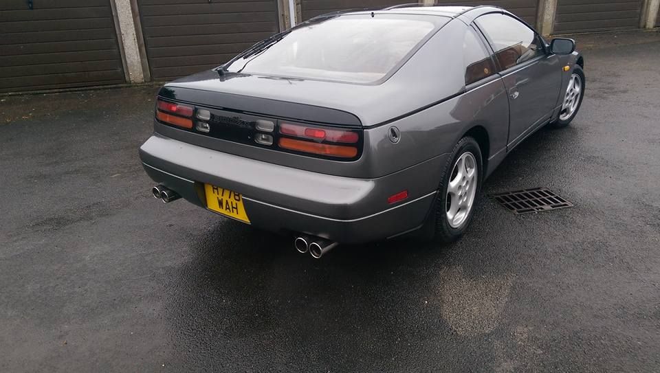

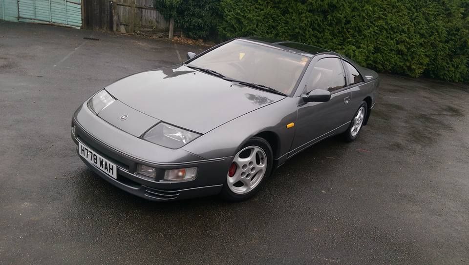

Here is my new purchase-

Looks very clean, has a TT front bumper and spoiler removed, looks like a respray but doesn't matter it looks good!

So the front bumper is not original? Did they all have rear spoiler originally? Is it a stock colour?

Right so the front bumper is for the twin turbo model, original but not for that car. Hmm I did think being a 91 it would have a 89 style spoiler but maybe I'm wrong. The grey could be the original grey colour, check the colour code under the bonnet
