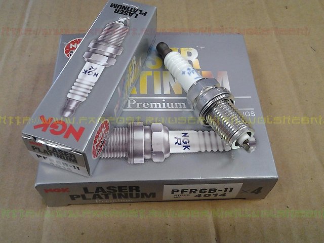

NGK code is 4014 I found they were cheapest.

But they are the wrong ones, except non turbo in Japan>
Need the 11c for the UK etc.

[ATTACH=CONFIG]109120[/ATTACH]
Jeff
How so. Pfr6b-11 is correct of imports no?
"PFR6B-11 ( without the C ) are fitted as stock to Jap import TT and Non turbo for use in Japan.
Jeff"
Who said it's a UK zed
Jeff"
Not me? you just did ! I said and quote "NGK PFR6b-11c, are the correct ones for European zeds " I then said "Need the 11c for the UK etc.
" the etc. refers to the original poster as I had said European and he is in the Netherlands, which is close enough eh?
The fuel in Japan has different ratings freely available 100 ron etc, the plugs fitted to non turbo in Japan with Jap spec ecu map end 11 with no C. If the cars are to be used outside of Japan and not the US then the C ones are correct........... wow need lie down now !
Jeff
Simply YES 11c.
