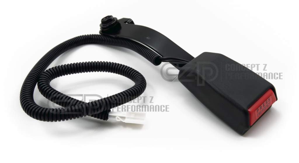

Some confusion here, so to clarify, modern seat belt pre-tensioners fit on the seat base, they have a small charge in a tube shape unit and form part of the belt latch, see the example picture below.
In the event the forward sensor detects a crash the charge is activated, this pulls the seat belt tighter, it also opens a circuit, that circuit forms parts of the air bag system, if the one time only pre-tensioner has activated the airbag light will be activated not the seat belt light, its also means the unit cannot be used again.
Nissan seat belt latch above, as you can see no tensioner charge unit fitted
The 300zx does not have these type of seat belt pre-tensioner, the seat belt latch only activates a switch, this controls the seat belt light just as a reminder to not drive without having the belt on, seems likely the circuit or switch in the belt latch is faulty
Note : The reel in the door or B frame does have a system to keep the belt tight, however it ofyen fails and the belt hangs loosely when not worn.
Hope that helps
Jeff
