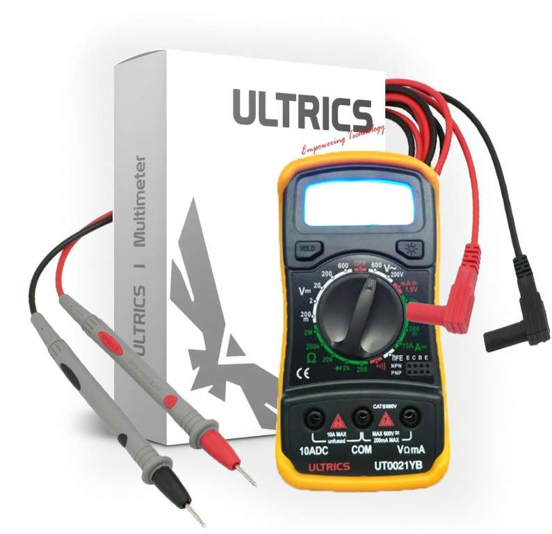

If you're looking at something like this:
It is signifying to use 200 for anything small. Then for larger resistances you go to the higher settings.
