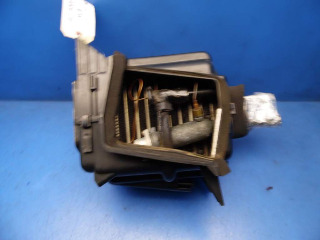

No, sorry for the blurred photo, all I could find, are you changing it as part of converting to the new gas, or is it faulty ?

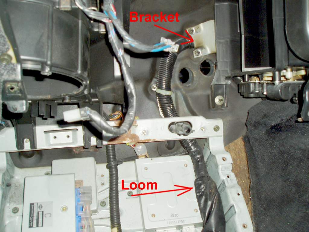

No not at all, take the passenger seat out, then the glove box, ducting, and fan motor and your basically there, the heater box is jointed to the ac part by clips and need releasing as well as teh fixings to the car. Of course remember you will need to completely undo the main ac pipes that pass through the fire wall at the back of the engine, and as I mentioned before are you changing it to upgrade to the later gas? if so the pipes are different and the threads do not match ( I know ) and you have to change the evaporator as well as the valve.

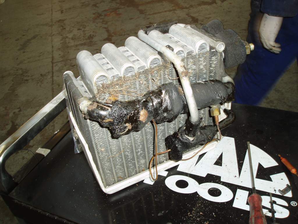

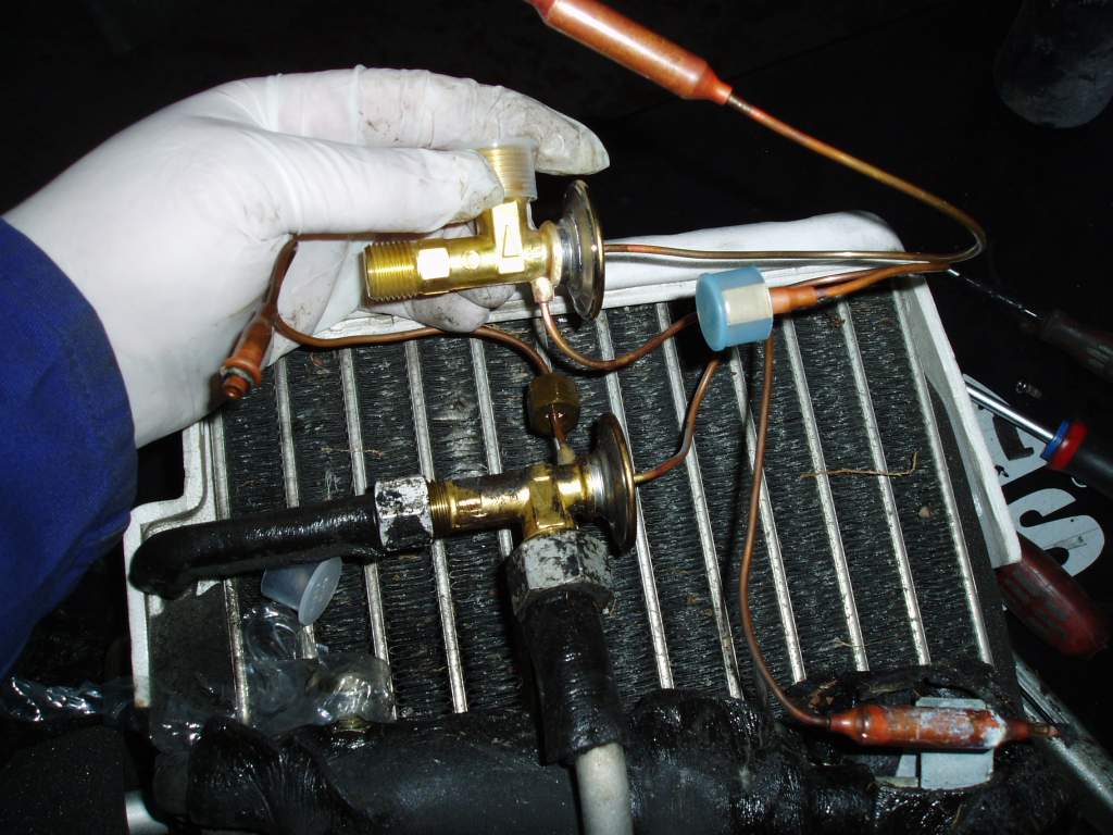

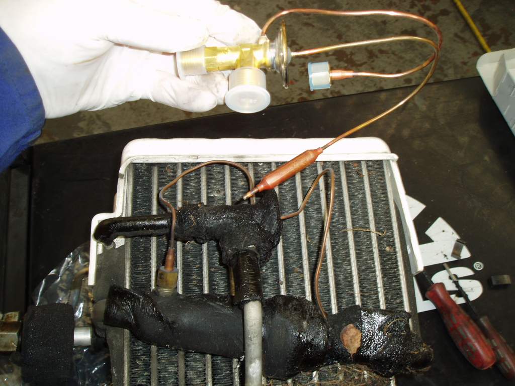

Ok had to dig deep but eventually found these on a memory stick, ( nick here will remember these lol )
First one shows the unit removed from behind the glove box, as you can see no need to remove dashboard.
Evaporator out and showing valve wrapped
Old valve revealed
New valve along side
