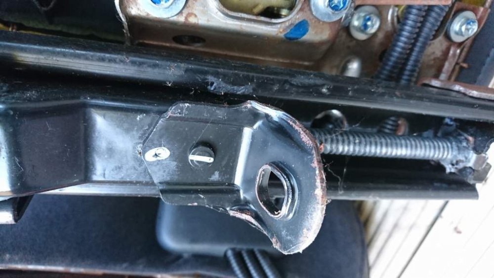

Do the seat rails differ on the later spec cars. Had a quick look at my new interior today & the drivers rail where they bolt to the car at the front are a slightly different angle so I'm going to swap the rails with a spare seat.
If you look at the sides it looks bent. It's probably been dropped or something and bent flat
I thought that but then I noticed a few more differences so wasn't sure. Plus it'd have to be a big drop to bend them both.
To the best of my knowledge, the Z32 floorpan didn't change over its production lifespan. So 1989 seats should bolt straight into a 2000 car (for example).
Think the brackets have bent. I've changed over the rails so the seat fits perfectly now.
