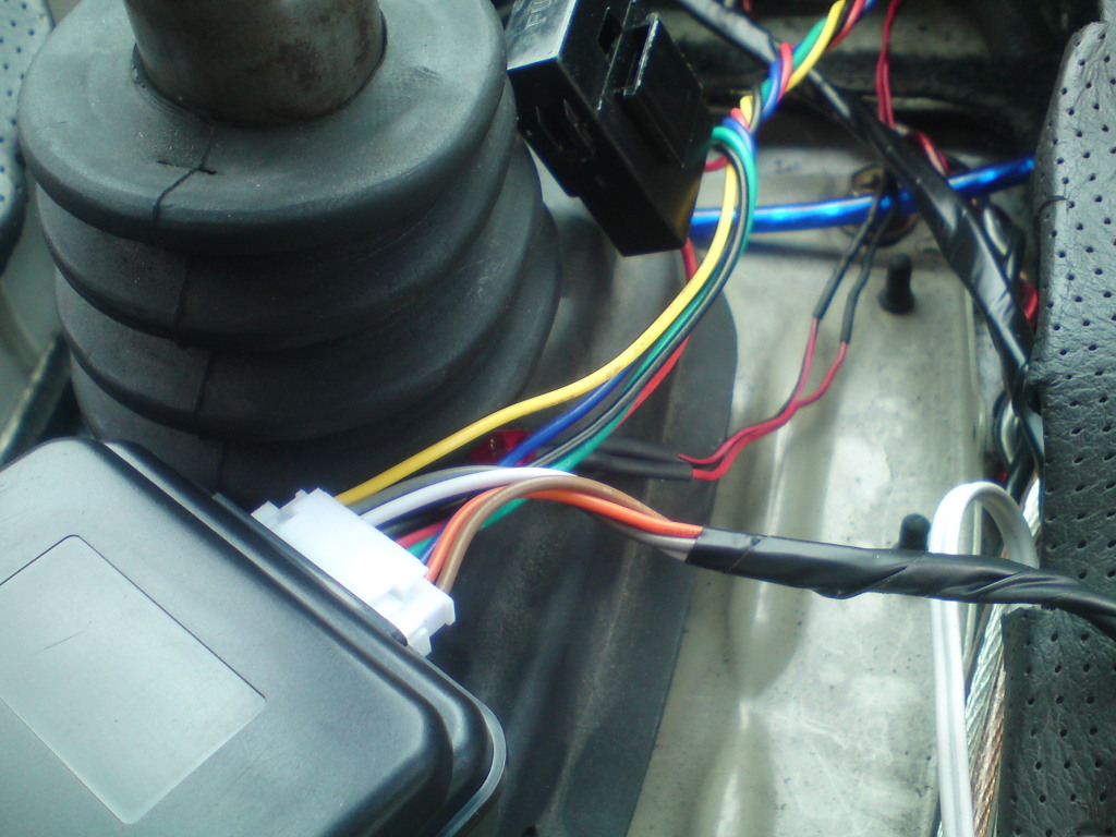

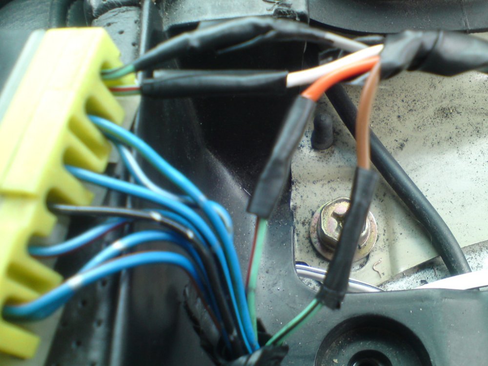

Ages ago i bought an automatic folding gizmo. Finally got round to wiring it in and needed to know the fold in and fold out wires and there are 4 to chose from
Presumably either 3 or 8 is power to the switch. Any ideas what the other is?

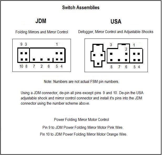

Oh why didn't you say, there is a post of mine that says what goes where, give me a mo.
Found it but the pics don't host, i'll try and sort.
https://www.300zx.co.uk/forums/showthread.php?159850-Auto-fold-mirror-module/page2&highlight=auto+fold+mirror
Edited by phutumsch
I've found the pictures to go with the link, hope this helps........oh i think the hosting is working again, the fact i logged in after a while seems to of brought them back !!
Edited by phutumsch
Thanks
That was the thread I was trying to find

So I wired it up
On connecting battery live the mirrors folded in
On starting ignition mirrors folded out
But that's it, they havnt moved since
All I seem to have achieved is wiring my switch so put is in and in is out
