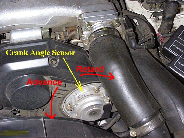

Standing at the front of the car looking towards the rear, which way do i turn the CAS to retard / advance the timing.
Ta
Anti clockwise to advance the timing and obviously clockwise to retard. I recommend using a timing light whilst doing this as getting it badly wrong can have major problems, I.e., detonation and overheating.
Same as everything on these things, opposite to what you'd think lol
