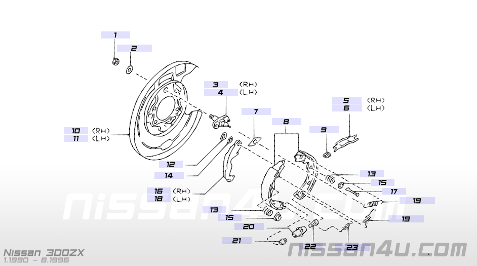

Hi, had some weird noises from rear wheel. Took disc off and bits of metal fell out. Looks like one of the spring clips that holds the shoes steady has disintegrated.
kimd of hard to explain but there's one per shoe, it looks like it holds the shoe against the hub. It's a pin about 1 inch long with a slot for a flathead screwdriver on top and a spring around the outside.
Anyone know where I can get a replacement?
Cheers
The retainer is actually three separate parts (13, 15 and 17) in diagram below with their part #'s listed in the link here:
http://nissan4u.com/parts/300zx/el_z32/1990_1/type_1/brake/rear_brake_and_parking_brake_control/illustration_3/
Try Mike@MJP (trader on here) or http://www.allcarpartsfast.co.uk (they do Nissan parts to your door).
