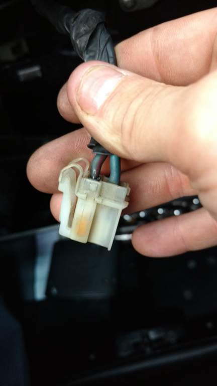

second would be, while cleaning leaves and other rubbish out of my air box i noticed how hot the wires for the fan had become, enough to be almost uncomfortable to hold and discolored the connector. worth taking it apart for a clean?

[ATTACH=CONFIG]106933[/ATTACH]

As for the connector getting hot? looks to me as if it is shorting out, definitely needs investigating.
I would pull it apart and investigate.
Does the fan run when you disconnect the ECU temperature sensor?

Think I'll be taking the fan apart and checking the resistance of each winding in the motor and greasing the bearings. Seems to me it's drawing too much current

Check the connector terminals (male and female) for corrosion. Any resistance between the pins with the high current demanded
by the fan will cause the connector to heat up. The wires heating up will be the copper taking excess heat away from the connector.

All of the wire all the way back to the resistor and the loom are hot too though. At work today I'm sure I'll have some time to take it apart and look lol
