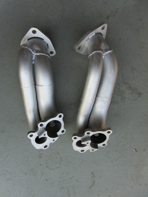

I have a pair of Specialty Z 5-bolt Super Split Down Pipes. I'll take pictures and measurements for you
[ATTACH=CONFIG]106767[/ATTACH]
Thanks AndrewG, those are a bit different then mine, as one of the divorced pipes is a bit bigger on yours, but at least I have an Idea of the depth

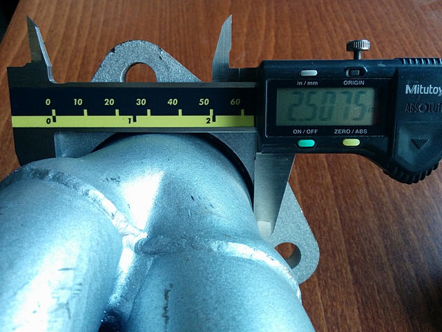

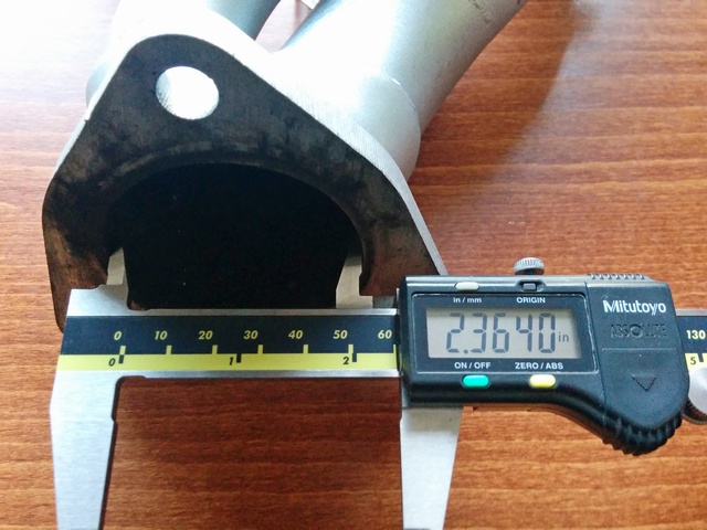

To be honest I haven't measure it yet, but I will later on. But I think they are 2.25"
Interesting, if you take a look at the SZ page for exhausts you can see that 2.25" is for NAs, and 2.5" (and then 3") for TTs:
http://specialtyz.com/shop/300zx.html?cat=7
These are outside diameter measurements.
