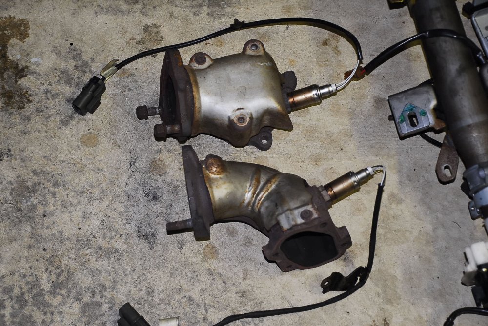

I don't have any at the moment, but the sensors are Cat Temp sensors and can be removed.
As Andrew says, on the turbo elbows they are O2 sensors, not advised to remove.
Also many decat downpipes pipes keep the standard elbows so you may not need to mess with them

The sensors on your stock downpipes are O2 sensors.

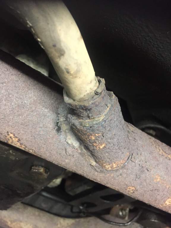

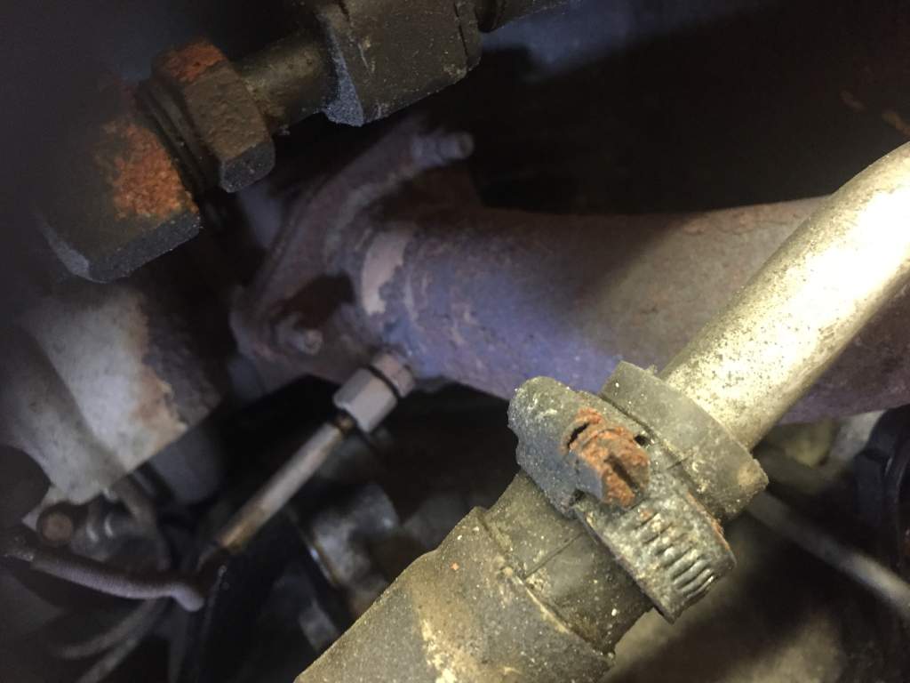

I take it the o2 sensors are theseIMG_2360.jpg Can try & get a better pic if needed!
The first pic is AIV which pulls fresh air into the exhaust to 'cheat' emissions.
Second pic in not sure, it's not where the O2 sensor is located and i haven't seen it before

No. They (one on each exhaust) are air inlets and part of the AIV system:
http://s95014253.onlinehome.us/63104/137858.html
and more pictures for RHD car:
http://www.pexcom.com.au/z32cms/e107_plugins/content/content.php?content.529
Pictures of the O2 sensors I posted previously in this thread.
