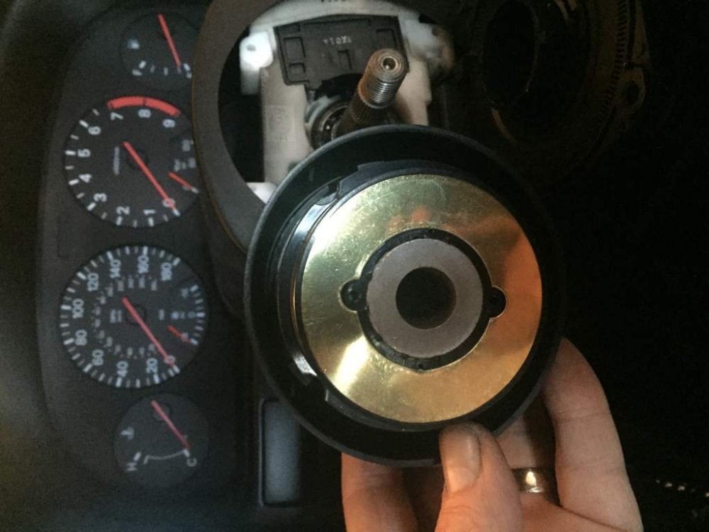

So I have been looking at getting my Momo wheel on this evening. I have just deleted my Hicas, and was told that I could fit a non hicas boss to my steering column. However the HKB boss looks like this
And won't fit due to the brass ring being in the way.
Is there anything I can do to adapt my current boss? Or do I need to order a new Hicas boss to fit the current setup?
Thanks guys
The brass ring if for the horn, and those holes I think should have pins in for the indicator deactivation. Which bit of it doesn't fit? Can the whole thing simply not go far down enough to seat on the splines?
It will fit into the splines, but there is a big gap between the steering wheel shroud and the rear of the boss housing
