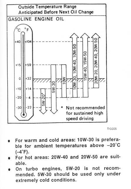

Info from the FSM:

As Andrew says above, a "30" grade of oil is going to be too thin for a twin turbo engine; once up to temperature. You'll need a minimum of a "40" grade.....
Regarding the semi vs fully synthetic argument, Nissan did specify 10w40 semi originally; so nothing wrong with doing that. Some people have said fully synth is at best an unnecessary extra cost; or at worst, could give rise to leaking seals. Personally, I think that if fully synth had been more widely used in 1990, then Nissan would have specified that instead - so as it is a more advance oil, then why not upgrade?
Always use a decent, quality brand - for semi synth, something like Castrol Magnatec 10w40. And for fully synth, Castrol Edge Titanium 5w40, Shell Helix Ultra 5w40... You get the idea - no cheap rubbish... :wink:
