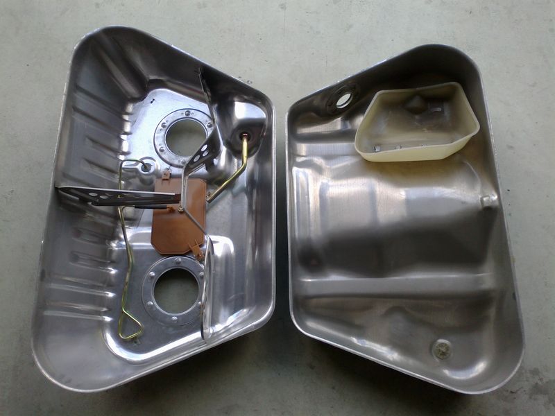

We are on about the fuel tank here right? I have this inside my tank, with that pipe coming from the now broken pipe on the surface. Sorry for the blurry pictures..
Took me a minute to work out what I was looking at. Here are the insides of a 2+0 tank. Same gubbins in principle.
I don't (yet) know what the brown plastic box does, but to answer your question the metal pipe inside the tank
should be connected to your repaired CC connection.
I assume it'd just be because it's the highest point in the fuel tank to allow vapour in, and the fuel gauge lever will hit it to indicate the tank is full so there will always be some vapour in the tank. But that's just a guess
I'll see if I can disconnect the pipe from the flexible red tubing in my 2nd blurry pic and make a new one up adding fittings like a brake pipe.
