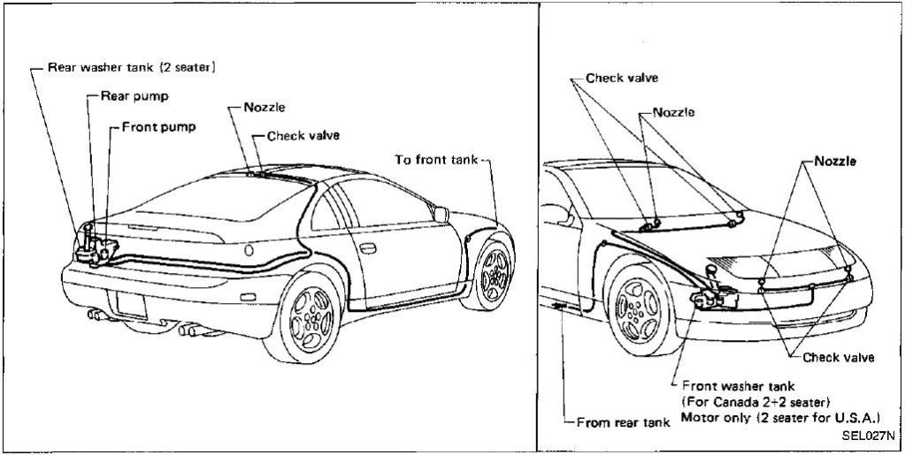

Where is the actual bottle and the pump?
Ie do I remove boot trim or wheel arch cover or somewhere else?
[sIGPIC][/sIGPIC]
It's all there in that back corner, my bottle however on series 4 is on the r/h front corner with a pump for front and a pump for the rear screen.

In case you haven't got round to finding it yet, it's immediately underneath where the filler hole is, back left.
Middle trim panel at the back has little thumb screws to pull it off, then the corner panel comes out with a few screws.

On SWB the rear bottle and pump for screen washers, the bottle feeds right up to the RH front corner of the car where there is another pump to feed back to the screen washers. On a car I owned years ago the spigot for one of the pipes on this hidden pump broke off and the bottle would empty when the car was pointing slightly downhill. Access is through the RH front wheel arch - remove the liner to access the space ahead...
