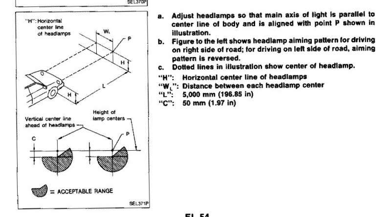

One of the fails in my other car was headlight beam to high, now without the proper equipment , how can i adjust it? I mean, it looks okay to me.
If it was only high on one side u can park on level ground turn on your lights and use the other one for reference, or if its both use another car with adjuster set to 0 if it has one and do the same but mark the beam height on the wall and swap cars and set your car to that.
That is a crude way to do it and to be honest your test centre should allow you to adjust (if they work) during the test.
I would get the MOT centre to adjust it for you - They've always done it for free for me in the past. However, bear in mind the adjusters are plastic. Do often sieze, and can break.
As a crude alternative to above, you can position the car, say 1m away from say your garage door and mark the relevant positions.
Providing that you are on a good flat service, you can then reverse the car backwards the 5m in a straight line.
If things are set correctly, the beam location on the garage door should not change.
If they do, you can then adjust as necessary.
