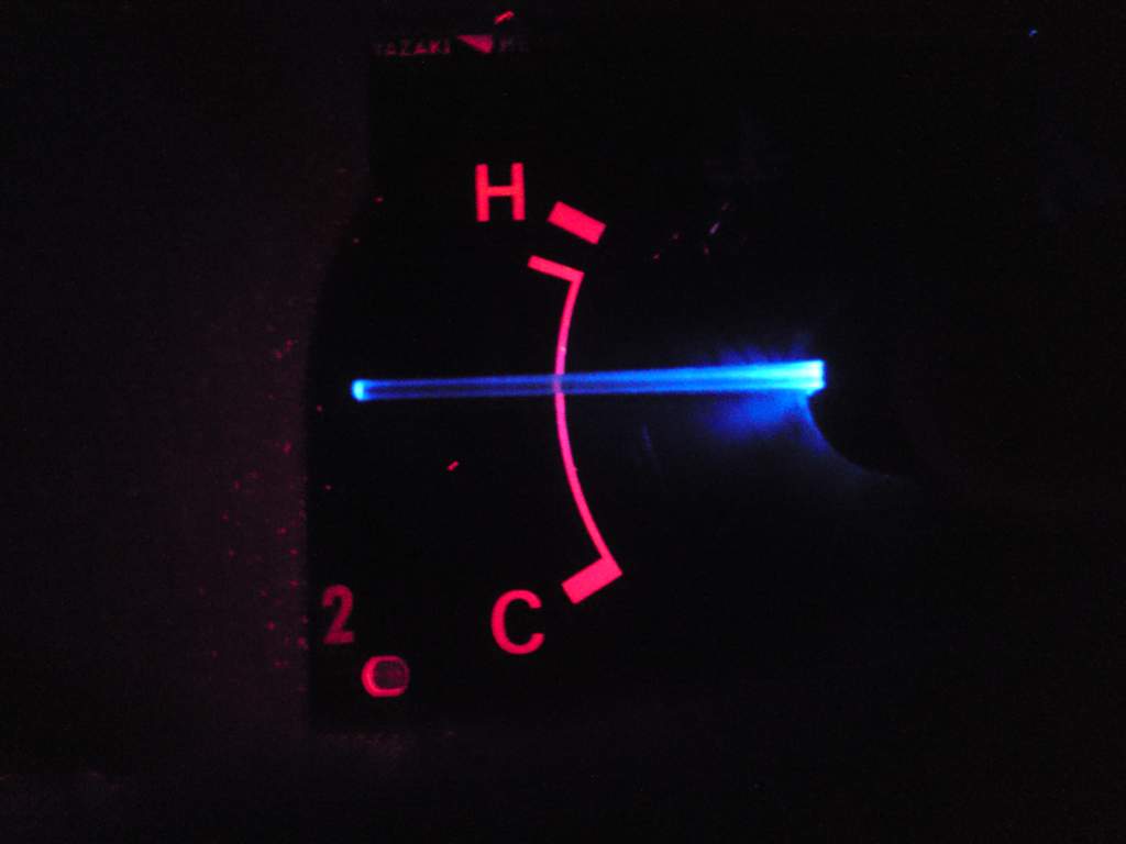

The needles and blue smd boards arrived, initially i was disappointed in the daytime and thought scrap this idea but as darkness fell i rigged up again and am now at 50/50 whether to rip out my cluster because i flicked the lights on and i have tremendously full red needles.
The reason for blue boards supplied with this kit is for cars apparently with no illumination there, we zedexers have, so it will be a fiddle positioning these locally at the spindle but under the clear diffuser so that not to foul anywhere, i do not want the blue bleeding anywhere else as of course i want to keep the red dial back illumination.
Another problem i have early identified is that the kit's needles do not fit on the fuel and temp spindles, they're a tad too large so some tiny amount of adhesive, silicone i thought will be necessary to engage. The longer needles fit perfectly on the larger two dials, so we have a plus there.
Anyway, here's a quick bench simulated pic, i think i may be mad to proceed with this but i may not be able to resist the draw of having something a little different that may well look very nice and add to my red/blue theme or it might just die a death very quickly !!
