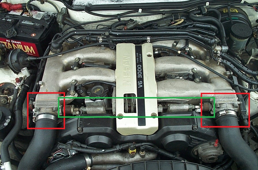

Maybe someone can tell what that rail at the front is called for future reference....
The rail that runs across the front of the plenum
Which rail...?
This one in green?
Also WD40 isn't strictly a lubricant personally I would stick some mechanical oil on it for long term prevention.

Yes mate, and WD was all I have at the mo. My Dad recommends 3 in 1, what about you guys?

Well, if I'm honest it was a little bit of sticking around where the throttle is attached to the rail at the front. The wheel thing didn't spring fully back but about 4mm which I couldn't see at first until running and I moved it back into place.
