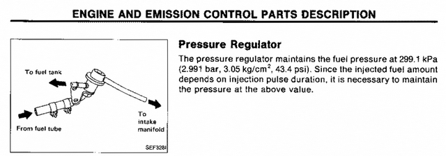

The OE fuel pressure regulator should maintain fuel pressure at ~36 psi at idle with vacuum reference attached, 46 psi at static manifold pressure, then increases fuel pressure 1:1 per psi of boost.
46 psi fuel pe for stock boost about 12 psi
For 15 psi i should rise the fuel pressure to 49 to 50. Is that right
