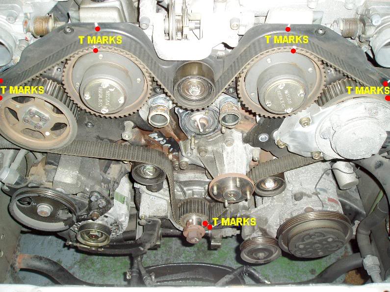

Checked left hand cam timing too? so you removed the two metal water pipes to get access to remove the left cam cover ? ok if you did, strange for one side of the engine to be effected by the maf when both sides share the same manifold ?? if you have a screen shot of the diagnostic when at idle, one thing that comes to mind is the throttle position sensor, this can cause all sorts of running issues,especially of the hard idle switch is activating at the wrong time, saying that again this would effect the whole engine not one side, its is possible you have more than one problem that is compounding finding any one of them.
Here is a tech thread to basic belt timing I did some years back > http://www.300zx.co.uk/forums/showthread.php?135139-Align-timing-belt&highlight=cambelt
Did you have the top of the engine at least this stripped???

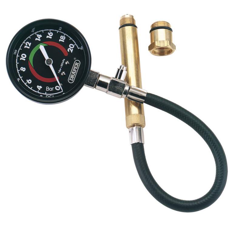

The type of compression tester you need is as below, cheap on e-bay, available at Halfords but dearer, local motor factors be a good place to try.
